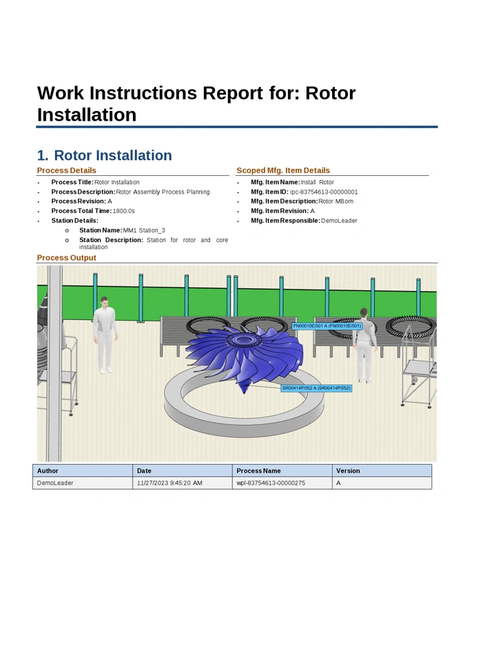

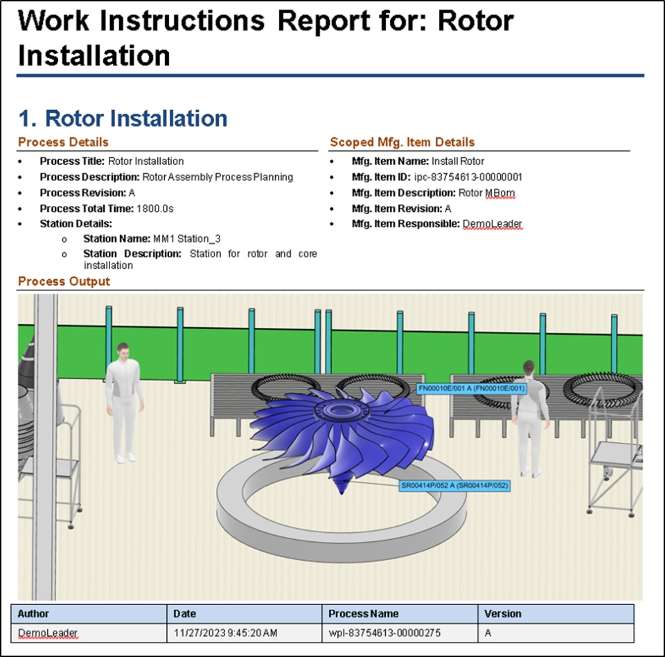

In this report various pages are generated which are as given below:
Front Page (System Level)
Front page shows information about:
  1. The Workplan system (selected as input)
  2. Mfg. Item. Scoped to the Workplan/General System
  3. Last view of last operation (Ideally, this should be the complete product build up showing the complete 3D Model of product manufactured. Workaround is needed to make this working).
Here,
  1. Process Details: This shows the information of the selected Workplan.
  2. Scoped Mfg. Item Details: Shows the details of MFG item scoped with the selected Workplan.
  3. Process Output: Last view on the last name. It shows the final output of the System/Workplan.

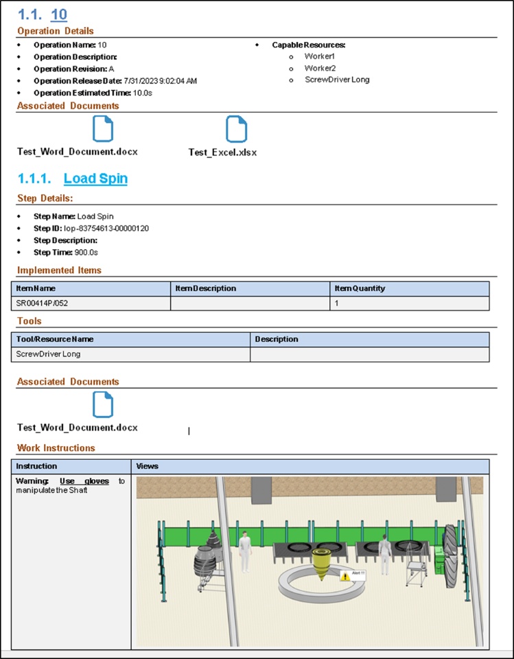

First Page (per Header Operation + first step operation below Header Operation)
This page is shown for every Header operation and the first step inside the Header operation.
Here, the information is exported as given below:
Here,
  1. Operation Details: This section lists the information of header operation.
  2. Associated Documents: This appears in both Operation and step section. This section contains hyperlinks for document, which are attached to the operation/step.  Double clicking on the attachment will open the document in new window.
  3. Step details: Details of step(Child of Header operation)
  4. Implemented Items: Mfg. Items assigned to the Step (Rolled up MBOM). Details are available in section 6.3.2 of this document.
  5. Tools: Capable resources of the step.
  6. Work Instruction: To export WKI, a table is created with 2 columns. 1st column contains the Work Instructions and the second column contains their relevant Views. (To link the Work Instruction to the Views, please follow the steps given in section 6.3.4 of this document). All the WKI’s available on the steps are exported one by one in the table.

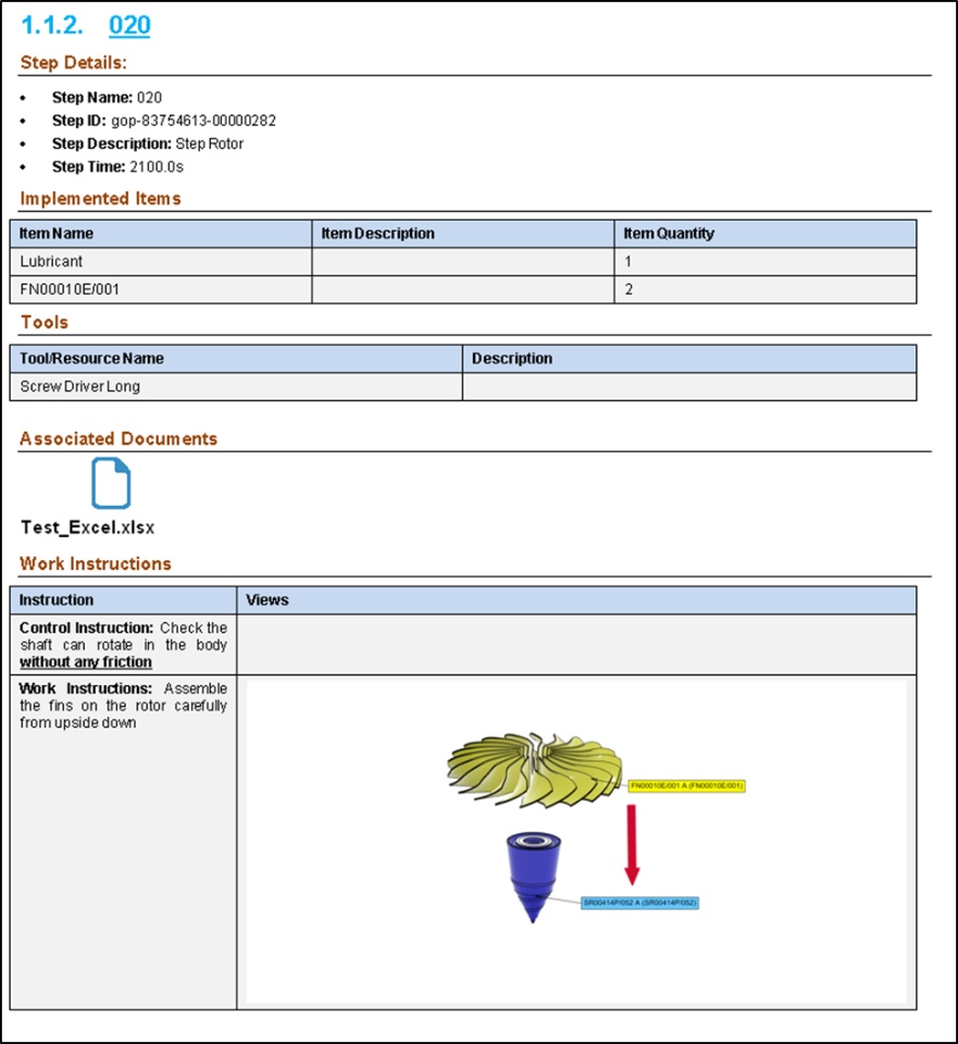

Additional Pages (For remaining step operations under the header operation)
These pages are created for all remaining steps / loading operations below header operation.
