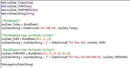

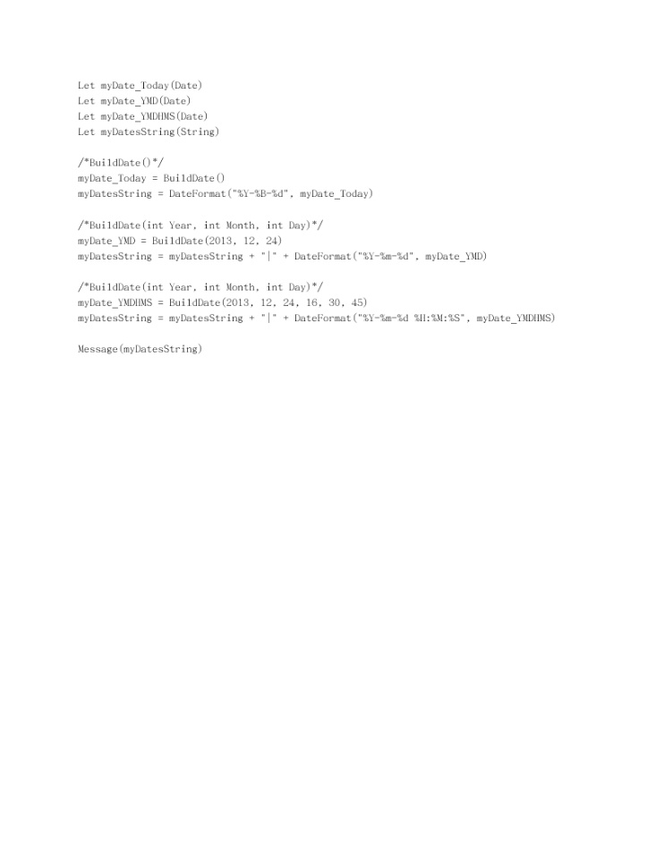

There are three constructors to Build a date, please refer to the attached example. So you just create your date and assign it to your date attribute.
