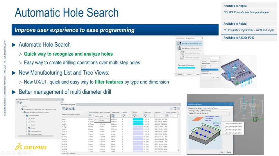

[Reuse Feature Recognition] "Is it working with Holes and hole patterns?"
=> Yes, but we advise to use the new "Hole search" command for the holes and patterns.
