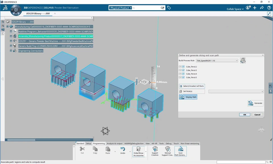

... Once you are about to define scanning strategy:
10/ To open "Generate output" command then to check that "eos" option appears inside the "Format" dropdown list.
11/ To click on "Build strategy" button.
12/ To pick one from dropdown list next to Build process rule and to define Scan path rule on all regions.
            To validate assignment.
13/ To click on Generate.
14/ To open "Display scan path" command to review the trajectories coming from EOS APIs.
15/ To open generated eos file in EOSprint.
15/ To review task file then send it for manufacturing.
