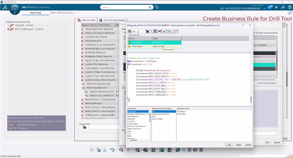

Using Machining Resource Upgrade business rule, we can set up the default initial values while upgrading any type of machining resource. To explain this business rule, we have taken example of End Mill Tool.
When user upgrades End Mill Tool, "DELNCUpgradeResource" business rule gets executed. In given example, we have locked the modification of tool parameter "Number of Flutes".

Similarly, we can do the setup for Face Mill Tool, Tool Holder and so on.

Important Note: This Business Rule is very similar to the "InitResourceAttributes" Business Rule. The key difference between these two BRs is that the "InitResourceAttributes" BR is for setting the initial default values when creating new machining resource whereas "DELNCUpgradeResource" BR is for setting the initial default values when upgrading the tools imported from V5 or other tool managers.

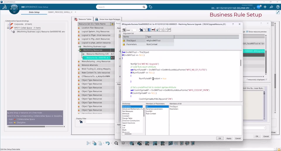

Business Rule Setup
Business Rule opening Id - DELNCUpgradeResource_ID
The Business Rule can be executed in two different ways.
  1. DataSetup App: If you create the script through DataSetup, it remains persistent in the database, is stored on the server and available to all. The script opening ID will be available under Machining Resources.
  2. CATRule/CATRuleExit: If you create the script using a CATRule, you must store the files DELNCUpgradeResource.CATRule and DELNCUpgradeResource.CATRuleExit in ..\resources\knowledge\scripts. You can then edit the CATRule file or create a new CATRule and CATRuleExit files with an Opening ID of DELNCUpgradeResource_ID.
    You can then execute the Business Rule when upgrading tool resources.
    Note: Be careful while using this method as the setup is done on local machine and it is not available to all users. Each user will have to do the setup individually.
