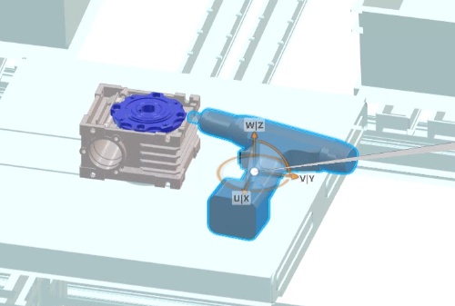

Tool Position & Orientation has a big influence on the manikin posture.
We are always trying to find the best posture for you. But depending on the tool orientation and position, we could find totally different postures.

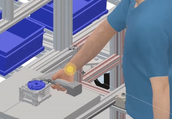

Lets pretend we want to grasp this nut runner.
The resulting posture with this tool orientation is the following:
The position of the tool is OK but its orientation is not... In result, the manikin posture is pretty dumb.

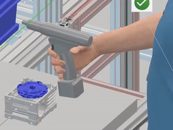

Wow, you can see that just by changing the object orientation, the manikin posture is now perfect !
Conclusion
If a posture doesn't make sense for you, be sure to orient and position the tool in the right way.
