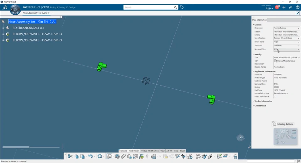

Case of Piping Assembly
Case for Hoses :
Note : for more details see dedicated hose wiki page here
