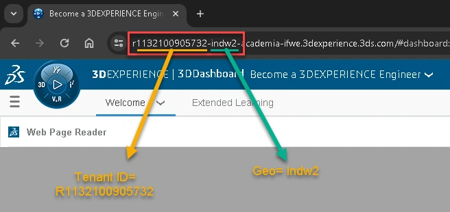

Tenant_ID & Geo can be seen in the browser URL when you access 3DEXPERIENCE platform Web Apps.
Note: R in the Tenant ID should be in Upper Case (See Image Below 👇)

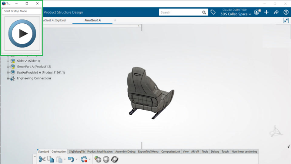

 A2 - How to Use Client Side TSM for Native Apps
After Launching Client Side TSM for Native Apps:

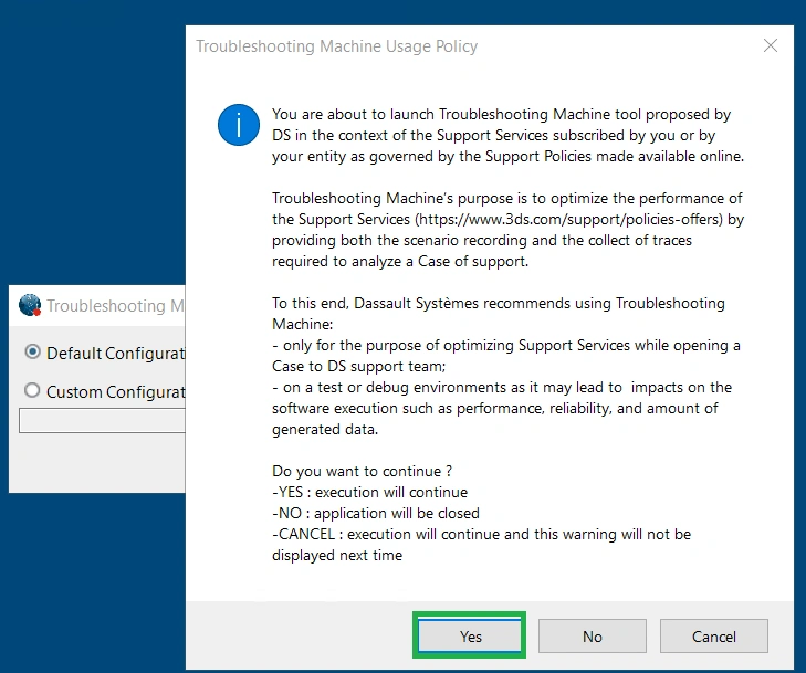

  1. Click Yes in the Troubleshooting Machine Usage Policy panel.

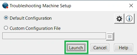

  2. Click Launch in the TSM Launcher panel.

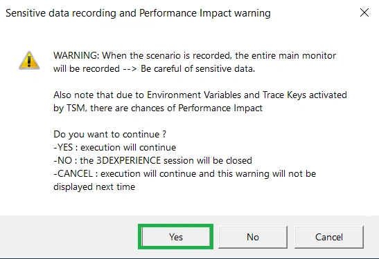

  3. Click Yes in the “Sensitive data recording and Performance Impact warning” window.
  4. Both Native Apps rich client and TSM are started (the two UIs are displayed with their own icon in the Windows taskbar).

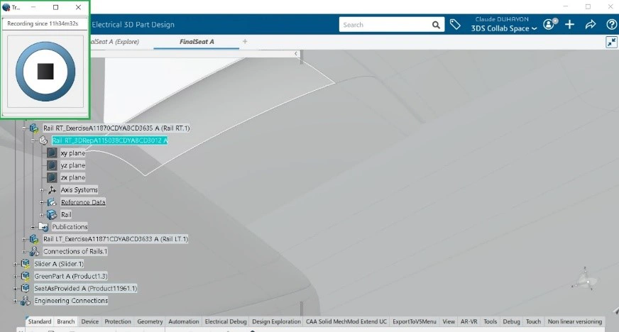

  5. Click on Start when you are ready to capture your scenario in the Native Apps rich client.
  6. Icon for the “Troubleshooting Machine” is blinking in the Windows taskbar. An additional third icon is displayed in the task bar. It is related to video recording. Please do not close it

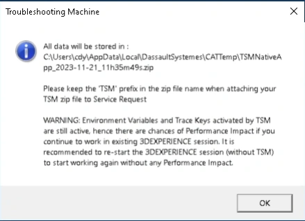

  7. Click on Stop button when you are done capturing the scenario.
    A pop-up window is displayed (to indicate that the TSM Zip file will be generated).

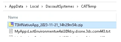

  8. After clicking OK, an explorer window opens and focuses on the TSM zip file in the %CATTemp% folder. 'Start  & Stop' is the default mode : user is able to generate several TSM zip files in the same rich client session. Default File Location is
    C:\\Users\\<Username>\\AppData\\Local\\DassaultSystemes\\CATTemp\\TSMNativeApp_<Date>_<Time>.zip

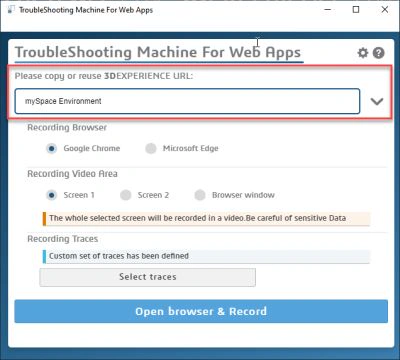

 B2 - How to Use TSM for Web Apps
  1. Start the TSM from the desktop (That was installed in previous step)
  2. Select or paste your 3DEXPERIENCE platform service’s URL

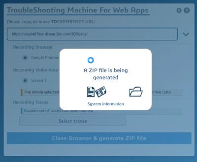

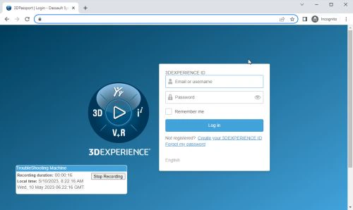

  3. Click “Open browser & Record”. The TSM launches a dedicated independent browser.
  4. Enter the credentials of the 3DEXPERIENCE platform

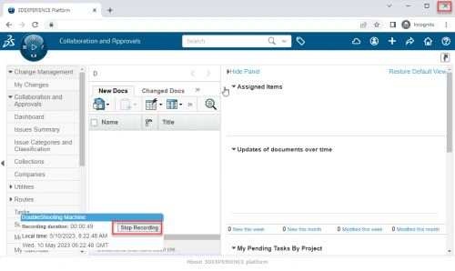

  5. Replay the scenario
  6. Close the browser

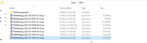

  7. The tool generates a single zip file containing all the needed information.
