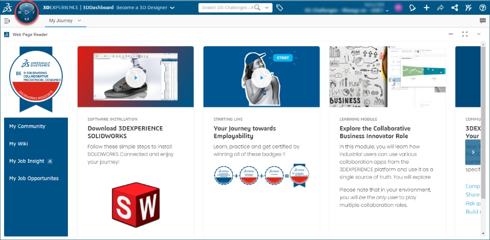

3. Click on the 3D Compass
Log in to the 3DEXPERIENCE platform and Click My Compass (Top-left corner of browser).

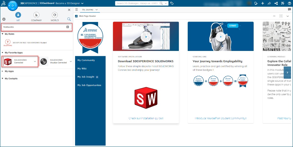

4. Search for SOLIDWORKS Connected App and click on it
NOTE: If you are not able to see the app like the one in the screen below and you're seeing a bunch of advertisements on clicking the 3DCompass, then you are not using the right login link. Please use correct Login Link and set it as a Bookmark.

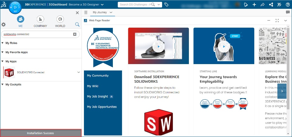

7. Message: Installation Success

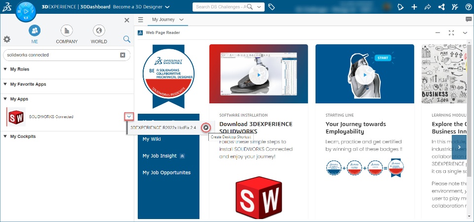

8. Create Desktop Shortcut
You can create a shortut of SOLIDWORKS CONNECTED app on your desktop.
