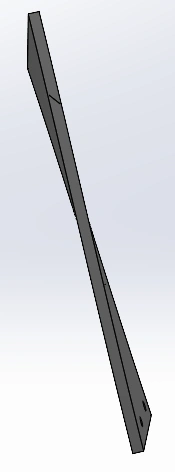

Trying to convert this part to sheet metal (twisted) - need to ultimately flatten it for laser cutting then form
Hi All,
As the subject says, I have a part here, its part of a large weldment the customer sent us to build.  The rest of the parts are just flats or rolled parts, but this part is twisted so not sure how to get a good flat pattern to cut it.  Its 5/8" thick stainless and there are 4 weldments so one for each.  For sheet metal, "convert to sheet metal" doesn't seem to work.  Likewise for "insert bends".  Maybe "Lofted Bend sheet metal"? - I haven't looked at this yet.  Never dealt with "twisted" parts for forming before.  Thanks in advance for any help!

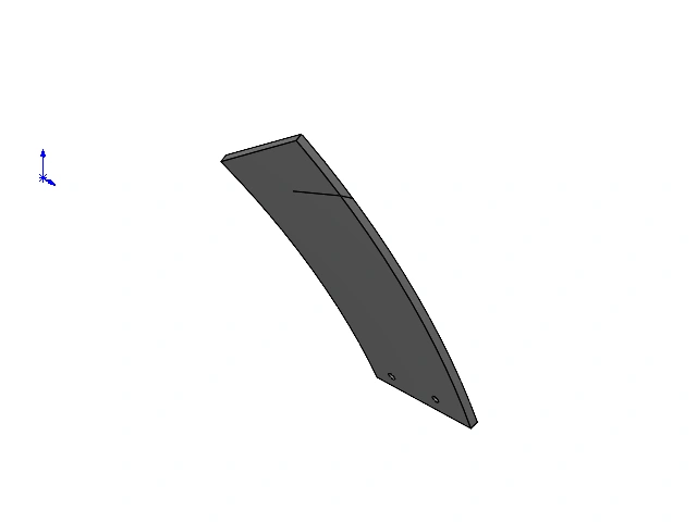

If you have SOLIDWORKS Premium or Ultimate, there is a tool called Flatten Surface. Its made for exactly this type of application. Simply select one of the faces and an "anchor point" and it will give you the flattened state. Here is a link to the help file outlining the tool. The tool is not unique to 2025, I think it came out around 2015. Good Luck and happy modeling!!

I'm not sure you are going to. The twist is what is hurting you from flattening. Id send it back to the customer and ask to make a part that can actually be formed. Some engineers seem to think that if can be drawn, then it can be made. No necessarily so.
JB
JB 2025-08-12
Even if you get a flat pattern.... How are you going to twist a piece of 5/8" steel to this exact shape?
That said, the twist is minimal.  I recommend throwing in a three-point plane to roughly approximate the midplane and the using Convert Entities to approximate the flat shape.  It should be within like 1/8" or so of "exact" (whatever that would be).

Thanks Craig and Josh for your input.  It is actually a "flight" that we normally get done outside by a sub with the proper tooling to roll/twist these.  But these are only small sections so figured we can get close by getting a close flat and heating/banging to make work.  Yeah, the twist seems to be only like 1-1/2" each way off midpoint.  Wouldn't be worried if carbon but cutting stainless may turn into junk and $ lol.

there is a "twist" command in Solidworks. Maybe you could "un-twist" to get closer.

Only SW Premium has the Flatten Surface command, but please see @Eric Beatty's reply in this post.
It is somewhat of a workaround to use Surface Flatten with SW Pro.

The flatten surface command in SW Premium seems to have worked good enough for me to cut the pieces.  Franco mentioned this.  Forgot all about this command.  Thanks to all for comments on this!
