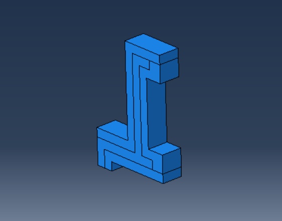

Hi Everyone,
I am running a thermal mechanical simulation using ABAQUS subroutine GAPCON to simulate the heat transfer behaviour at the interface in a die and a casting.
So In a 2D and a 3D model the model is failing at the corner most node of the die and casting could not understand why.
This is the sample 3D model

This is my GAPCON subroutine so just as the temperature goes below 555 as it comes to 554 the model fails and the message file shows that the "Heat Flux equilibrium not achieved "
Could anyone tell me what should I do in such a situation ?
It is a little urgent please can anyone help who has developed GAPCON earlier ?
