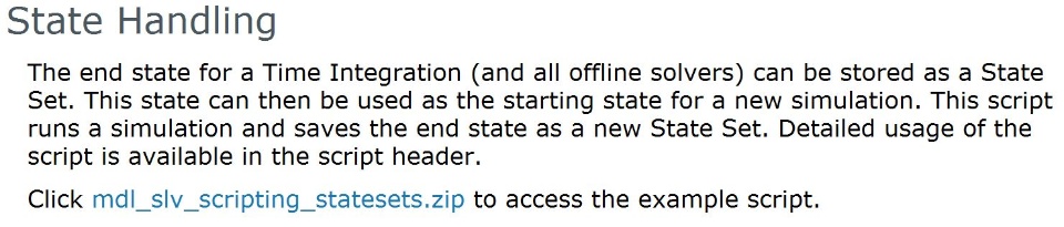

I also noticed this in the documentation regarding saving the end state after time integration to be used as the new starting state for the next run. Will saving the end state also save the wear on the rail which is to be used for the next iteration run?
f) If so, how do I get the rolling stock to return to the starting point of the track and perform the next iteration (without erasing the wear on the rail accumulated from the previous run)?
g) Also will using the command: myIniStateSet.copyToModel();
erase the end state accumulated from the previous time integration? So this negates the code (see below) to save the end state in the previous run?:
var myEndStateSet = myModel.createStset("\\\$ST_EndState");
