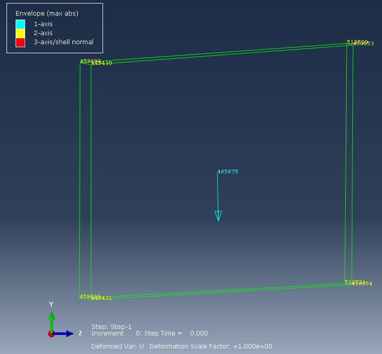

Hello everybody,
according to 1.2.2 Conventions in Abaqus Analysis User's Guide the the global x-direction is projected to an element so that this direction is then the local 1-direction. If the global x-axis is within 0.1° of being normal to the surface, the local 1-direction is the projection of the global z-axis onto the surface. In my case I've got strange results for some elements. When I assign 0° orientation to the model, the local 1-direction is actually then the global y-direction. Does anybody have a clue why is this happening or is it a bug in Abaqus? I'm using Abaqus 6.13-2 on a windows computer.
Here is my input deck
