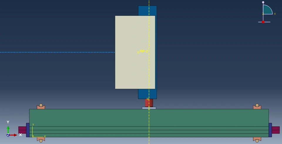

I am performing a temperature drop simulation in tendon (steel bar) which will introduce compressive stress in the concrete in abaqus/standard.
The simulation is working fine with temperature value i specified to the tendon is coming out to be same at last step. I am using Static/General step with 3d stress element for tendon (yellow color instance) and other elements. I have specified temp as predefined field. The objective of this analysis is to introduce tension in the tendon which will introduce compressive stress in beam (green color instance).

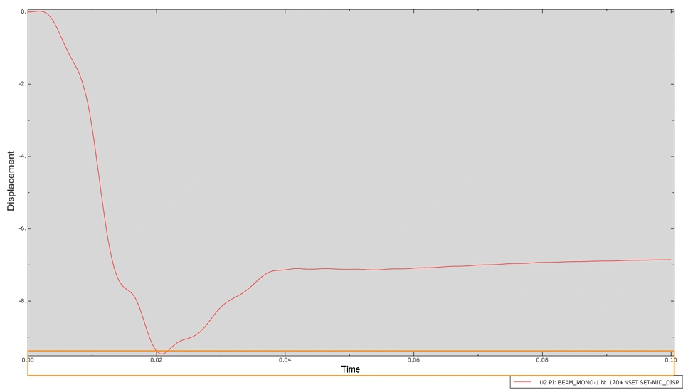

The job is submitted and the temperature is assigned to the tendon. During analysis, the temperature is constant but i am not getting the same effect as contraction in beam as i was suppose to get which is the displacement of beam at mid should return to zero at the end of simulation.
