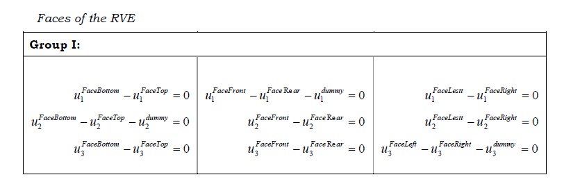

i have a problem with the periodic boundary conditions. I want to implement the boundary condition for example
which i found it in the internet. The first equotion is u_facebuttom - u_facetop=0

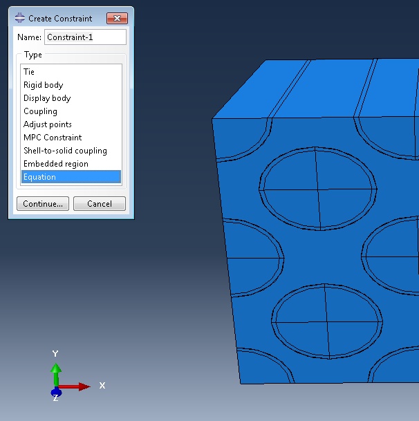

So i know that we can do this with creating Constraint and selecting Equotion.

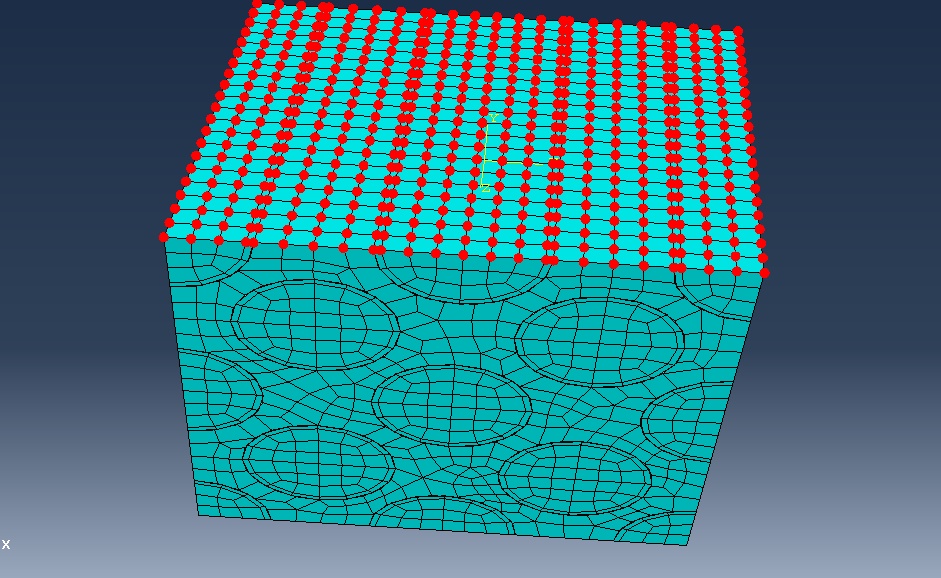

At first i define Sets FaceButtom and FaceTop which includes all nodes on bottom and top. Here is a picture for the Set Face Top:

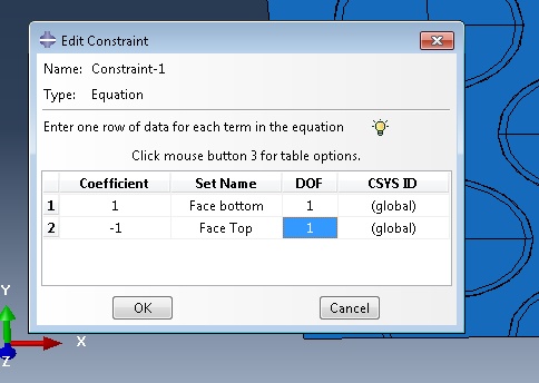

Now i want to implement it with creating a   Constraint and selecting  Equotion. My Equotion for the first boundary condition is  u_facebuttom - u_facetop=0
It looks like this:

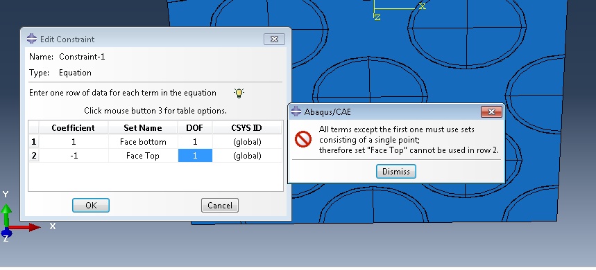

But now if i click the OK button to finish it for the first boundary condition, i get the Error: All terms  except the first one must use sets consisting of a single point; therefore Set " face Top" cannot be used in row 2.
Can somebody explain what i have to do ?
