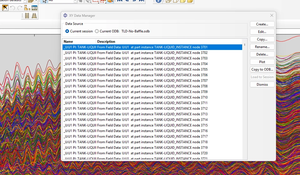

I am trying to extract U1 displacement for SPH nodes in Abaqus using Python. My goal is to write the displacement values to a CSV file, with time in the first column and displacements for each node in the subsequent columns.

i always get an issue with "Unexpected Indentation" -- for value in u_field.values:
