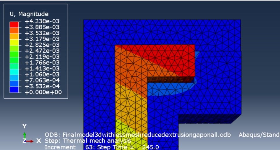

I am simulating a low pressure die casting arrangement in which we need to know the effect of gap formation on heat conductance.
Now what is happening is my casting is moving in the y direction due to contraction but it is entering the mesh of the top die like it is overlapping, I have attached a figure for your reference.
Please can anyone tell me what is wrong that I am doing?
I have defined Normal contact with a penalty stiffness of 1E+09 to model that the material of the die and the casting is stiff this I have done in General contact in the initial step.
Also then I am using a GAPCON subroutine to study the impact of gao formation, contact pressure and temp on the heat conductance also which I have attached in the post.
Please can anyone tell what am I doing wrong, also can anyone check if the written GAPCON is correct?
