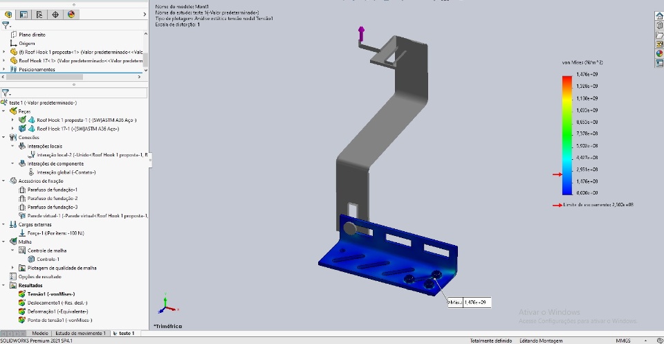

Good Morning. Guys, I'm on the back foot in relation to SolidWorks Simulation for linear static analyses. I'm running some simulations and, apparently, the components fail under really, really low loads. As an example, an L-bend profile with ASTM A36 in 3.0mm sheet fails with a load of 100N (approx. 10kg), this is impossible!
I've checked everything, mesh convergence, stress singularities, connections and fixtures, stress point diagnostics, mesh control in critical regions, model simplification and vice versa, I even tried to run it with 3 different adaptive methods (none, h and p).
Turns out that, in all different methods and simplifications and analyses, all the results converge and, except for the small particularities of each one, in all of them the answer is always very close and practically the same. The form of deformation is also as expected, with great precision by the way. So, I think the problem is not with the solver itself, as different inputs converge to the same solution. The point is, it always returns a very high stress state for very low loads, I have the impression that it is 10x more than expected, if not more (yes, I have already checked all the units as well).
Anyway, I looked so hard for the problem and I didn't find it, I begin to think the analyzes are really correct. But it's hard to believe that such low loads put such high stresses on the parts, it's not possible... Does anyone have any tips on what might be going on?
