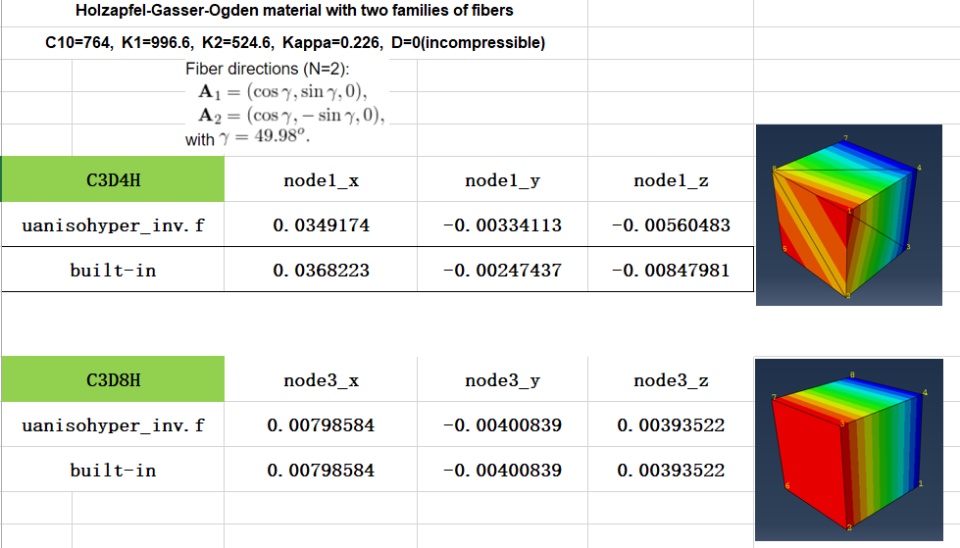

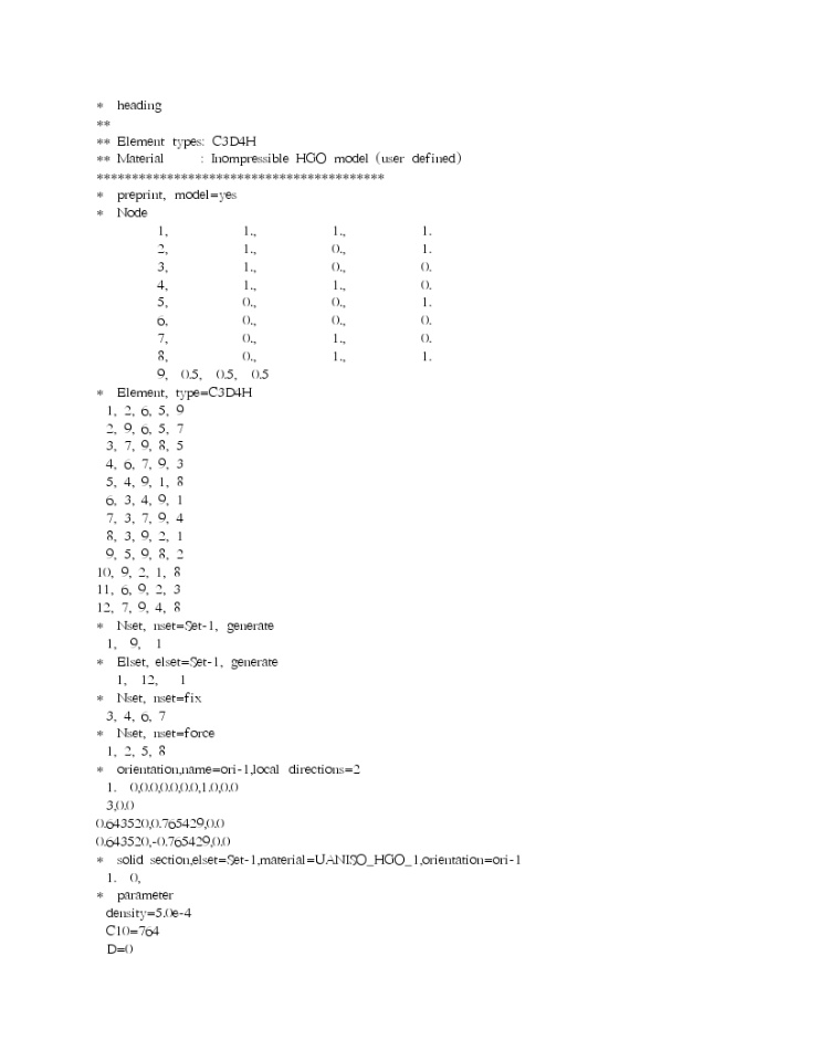

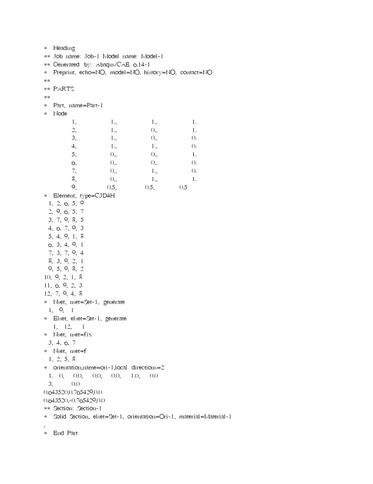

I do a uniaxial tensile simulation with anisotropic hyperelastic material HGO using hybrid element. When the model is divided into C3D4H elements, the results between user subroutines and built-in model are diffrent as below, why does this happen?
displacement
