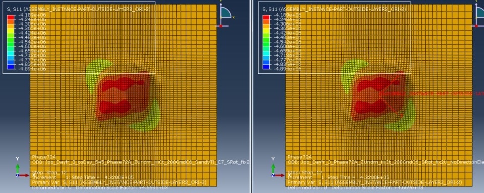

I have been reading the manual for a while and I still don't understand how it works for stresses in local material orientation. I defined a local material orientation which has xy rotate 45 degree clockwise. In element output, I have direction=yes for stress in integration point and averaging at nodes. Now I am trying to display stresses in local material orientation without any success until I tried using direction= NO in element output.
https://help.3ds.com/2020/english/dssimulia_established/simacaecaerefmap/simacae-m-resresultoptions-sb.htm?contextscope=all
*Orientation, name=Ori-1
0.707106781186547, -0.707106781186547, 0., 0.707106781186547, 0.707106781186547, 0.
3, 0.
*Element Output, directions=YES
E, FV, MISES, PEEQ, S, TEMP, VOIDR, POR
*Element Output, position=AVERAGED AT NODES, directions=YES
E, S
Here are some results comparison between direction=yes (Left figure) and direction=no(right figure).
The first 2 figures are stresses at integration points before transformation. You can see both result are displayed at global coordinates and the results are the same between direction=yes and direction=no.

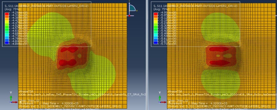

The 2nd 2 figures are stresses at integration points after transformation using menu of result option->transformation->select material orientation. Now you can see using direction=No (right figure), I can get stresses displayed at local orientation and it is different from left figure using direction=yes.

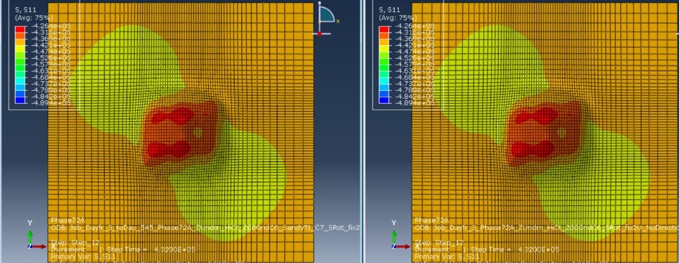

the 3rd 2 figures are nodal stress after transformation. The nodal stress are obtained using averaged at nodes. You can see all the nodal stress result are always displayed in global orientation and they are the same. I cannot never get nodal stress in local orientation.
