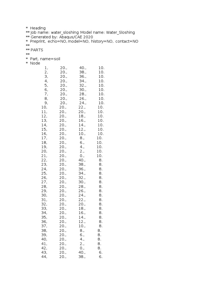

Hello, I am trying a very simple example of water sloshing using abaqus SPH. Please see the attached inp file. I try to set one boundary of the tank to a particle outlet boundary so that once my SPH particles reach that boundary, it will be deleted automatically. I modified the keywords in **BOUNDARY CONDITIONS section, added the following lines:
*PARTICLE OUTLET FLOW, BOUNDARY CONDITION=NONREFLECT
*PARTICLE OUTLET, NAME=Outlet,TYPE=SURFACE,SURFACE=tank-1.Surf-1
However, when I run the data check, it aborted with error:
"No element sets found on *PARTICLE OUTLET option for Particle Outlet OUTLET.
Parameter outlet is required."
