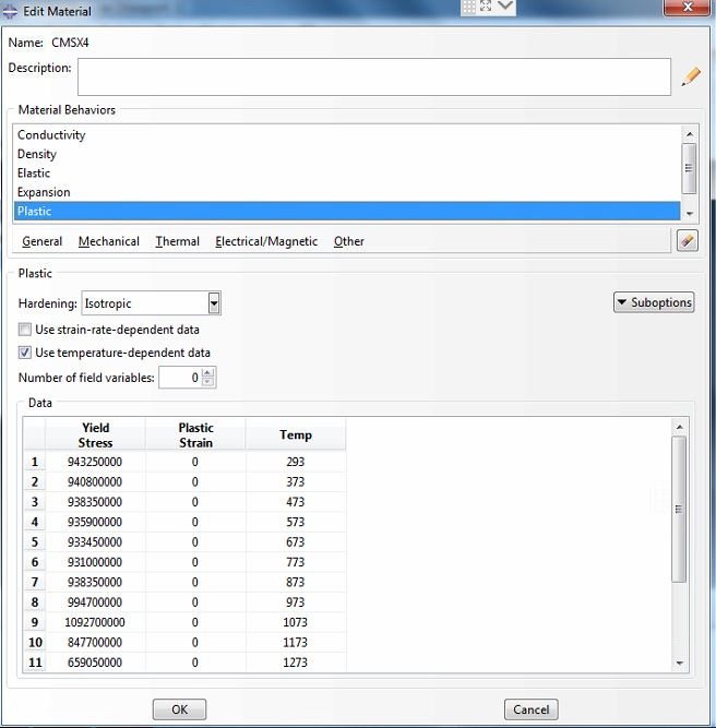

I performed a Transient Thermo-Mechanical analysis  in which I provided "Yield stress with Zero Plastic strain" at different temperature (see figure) and other properties like Elastic Modulus, poissons ratio, density,thermal conductivity,specific heat,expansion that is not related to plastic strain calculation.

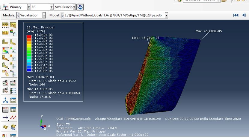

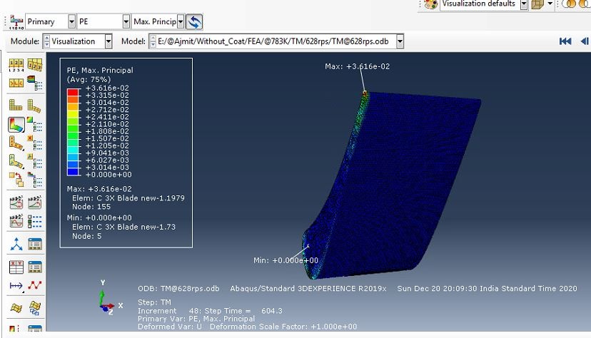

In the result Abaqus displayed such a value that maximum stress has gone upto yield stress at fixed(encastre) portion of Model. Also Abaqus displayed plastic strain of whole model (maximum plastic strain occured where yielding takes place.
My query is that how abaqus calculated Plastic strain if I haven't provided any data regarding plastic strain.
One more confusion is that Does EE & PE in Abaqus display elastic & plastic strain as so many other parameters like PEMAG, PEEQ etc. are also given there
