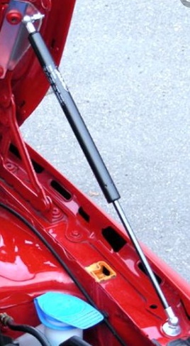

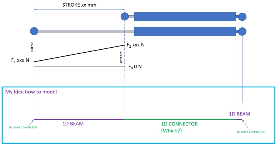

Hello Abaqus users,
I have question how to model gas strut (attached on the picture, picture is downloaded from google it not shows my case, but it is for engine hood too). I have the working graph for gas strut and idea how to model it(sketch on the picture). I do not have much experience with connector. This is why I please you Users for advise. Which connector to use, how to set it. Thank you.
