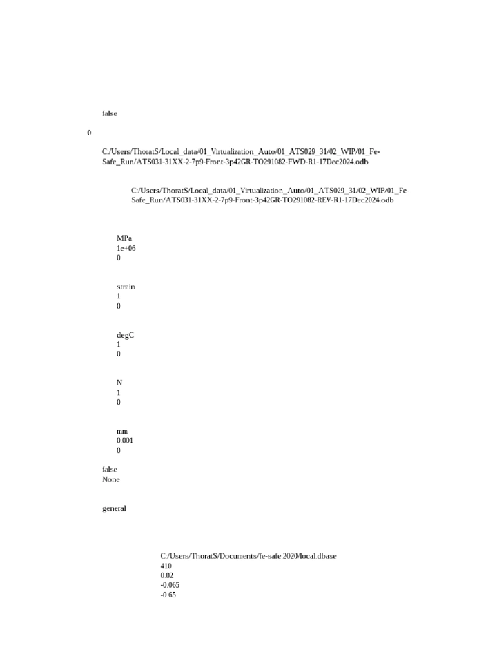

Also, I checked the stlx file generated by Fe-Safe. I noticed that the algorithm is not defined:
However, as this stlx file is created by Fe-Safe, this file should be correct.
