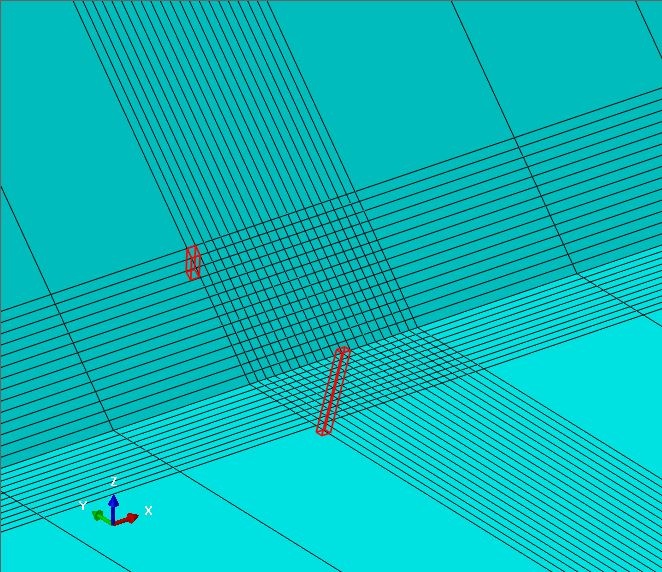

The crack front is defined as a shell in the middle of the refined mesh rectangle.
Element 135822 is far away from the crack front (top left in the image below), while element 169439 is adjacent to crack front.
What is the cause of this error? Which can be a solution?
