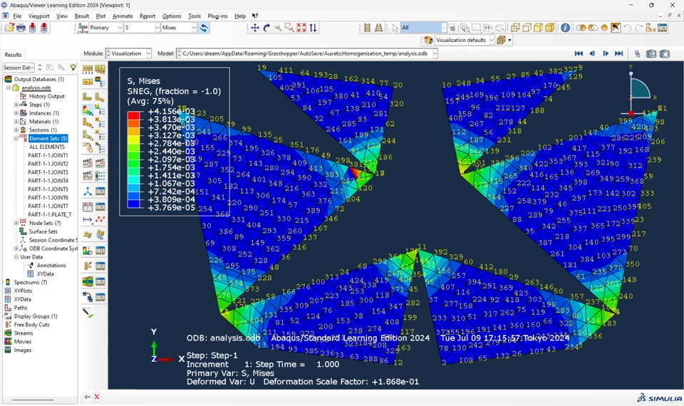

This time, the question is about the discontinuous stress distribution that appears around the element {381,311,150}, which is highlighted in red on the following screenshot. Considering the continuity of the adjacent face elements, the stress distribution should also be smooth like the other region. Why did I get a strange result only at the element {381,311,150}? I got the same result even though I changed the Abaqus version from 2024 learning edition to 2020.
I would appreciate your comments if you have any ideas on this problem.

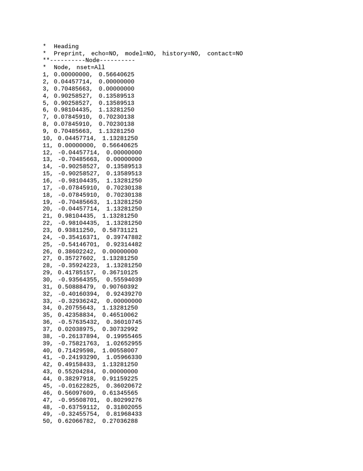

The following is my input file.
