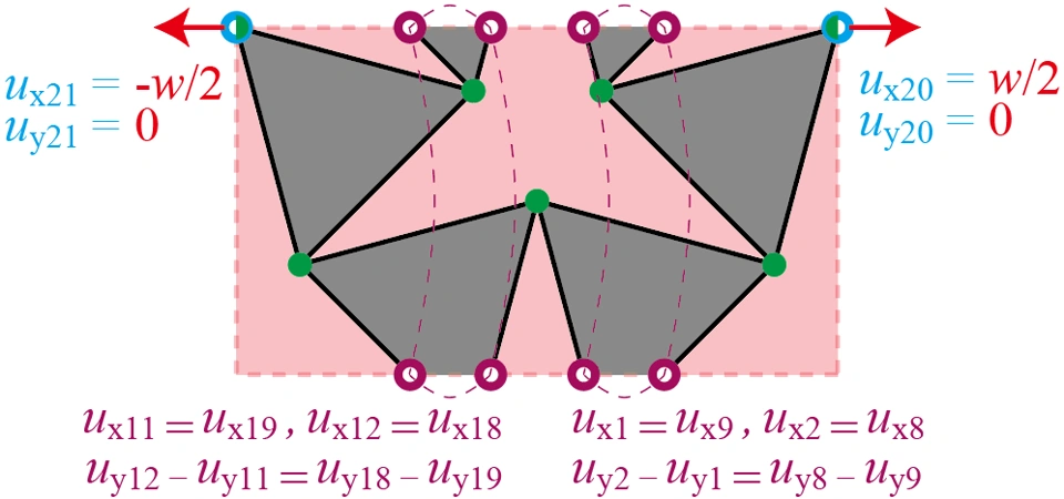

Hello,

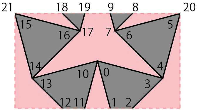

I have made an input file with 7 zero-length bushing elements with the node indexing (starting from 0) as follows:
I assigned the following boundary conditions including enforced displacements and linear displacement constraints:

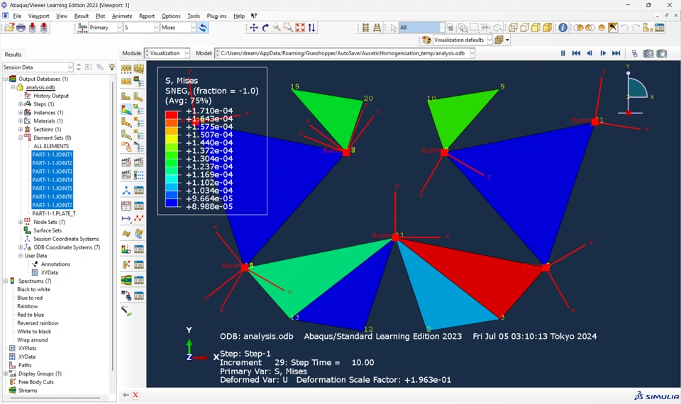

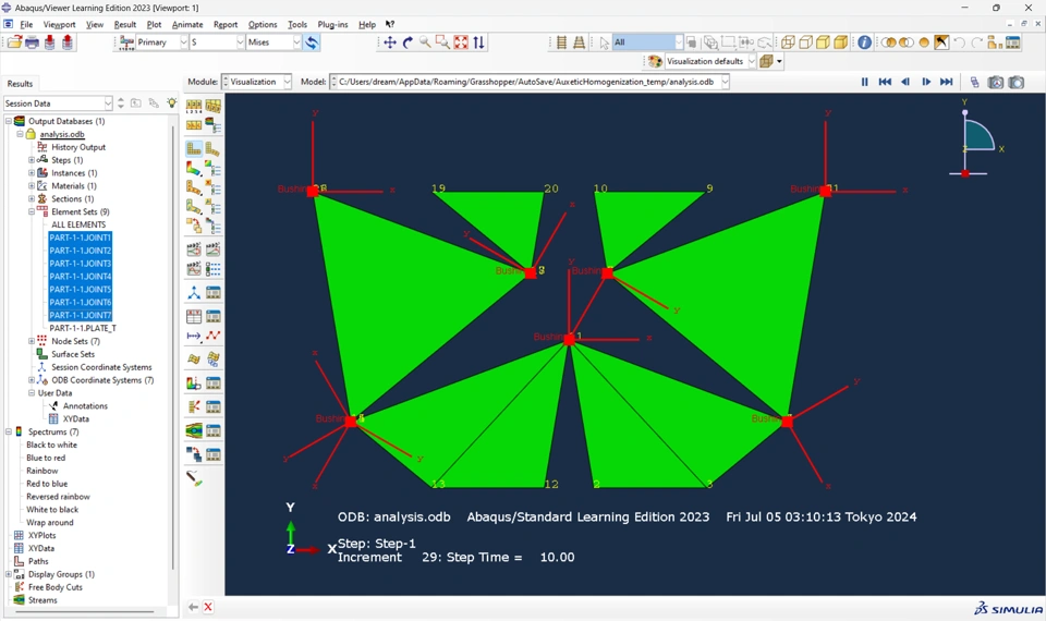

The result is almost satisfying, except that the orientations of the zero-length bushing connector are not as expected.
For example, the bottom-right connector should have the orientation with the local x-axis of
*ORIENTATION, NAME=ori_Joint2
0.50000000, 0.86602540, 0.00000000.
However, the resulting local x-axis is
0.50000000, -0.86602540, 0.00000000, as shown in the screenshot below.
Even worse, the bottom-left connector does not have consistent orientations at both ends, even though I specified the orientation property of ori_Joint4 at them. How do we ensure that the orientation of the bushing elements aligns with the specified *Orientation properties?
