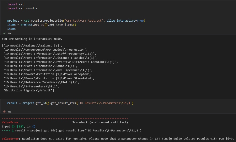

I am experimenting with the python interface. Specifically with the python library cst.results.
However, I am unable to access the results I am asking for.
I have attached a picture of CST Studio Suite for the project, where the result tree folder is visible. And the 3D Run Id's.
Using the following python code:
import cst import cst.results project = cst.results.ProjectFile('CST_test/CST_test.cst', allow_interactive=True) items = project.get_3d().get_tree_items() result = project.get_3d().get_result_item('1D Results\\S-Parameters\\S1,1')
I get the attached error
