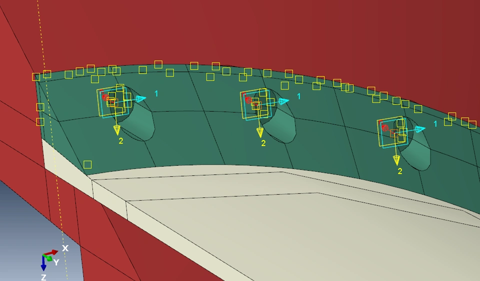

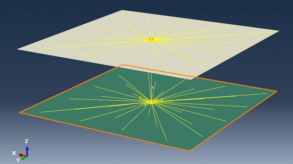

Hi,
I tried the assembled fasteners tool for the first time and I get overconstraint issues on whole nodes defined for the 2 surfaces in the main model.
"The job input file "Job-Test-AssFast-01.inp" has been submitted for analysis.
Error in job Job-Test-AssFast-01: OVERCONSTRAINT CHECKS: NODE 75 INSTANCE BRIDE-EXT-3 IS USED MORE THAN ONCE AS A COUPLING NODE IN THE *KINEMATIC COUPLING KEYWORD. REMOVE MULTIPLE USAGE OF THIS NODE AS A COUPLING NODE. THIS MAY BE DUE TO MULTIPLE MASTER NODES PRESENT IN THE REFERENCE NODE SET.
Error in job Job-Test-AssFast-01: OVERCONSTRAINT CHECKS: NODE 76 INSTANCE BRIDE-EXT-3 IS USED MORE THAN ONCE AS A COUPLING NODE IN THE *KINEMATIC COUPLING KEYWORD. REMOVE MULTIPLE USAGE OF THIS NODE AS A COUPLING NODE. THIS MAY BE DUE TO MULTIPLE MASTER NODES PRESENT IN THE REFERENCE NODE SET.
Error in job Job-Test-AssFast-01: OVERCONSTRAINT CHECKS: NODE 81 INSTANCE BRIDE-EXT-3 IS USED MORE THAN ONCE AS A COUPLING NODE IN THE *KINEMATIC COUPLING KEYWORD. REMOVE MULTIPLE USAGE OF THIS NODE AS A COUPLING NODE. THIS MAY BE DUE TO MULTIPLE MASTER NODES PRESENT IN THE REFERENCE NODE SET.
Error in job Job-Test-AssFast-01: OVERCONSTRAINT CHECKS: NODE 85 INSTANCE BRIDE-EXT-3 IS USED MORE THAN ONCE AS A COUPLING NODE IN THE *KINEMATIC COUPLING KEYWORD. REMOVE MULTIPLE USAGE OF THIS NODE AS A COUPLING NODE. THIS MAY BE DUE TO MULTIPLE MASTER NODES PRESENT IN THE REFERENCE NODE SET.

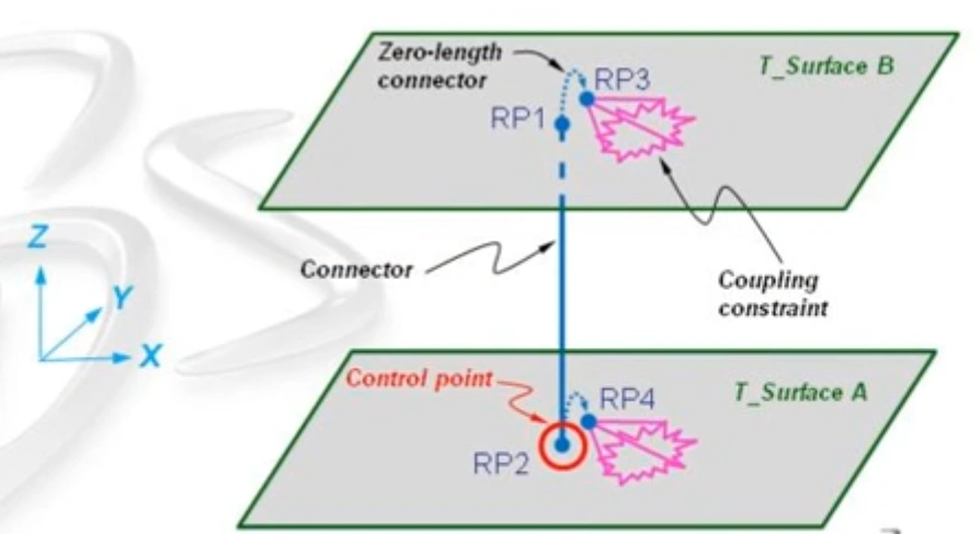

 I built the template following tutorial assumptions.I tried defining a 3D template but I get the same issue. Any idea ? Thank you.
