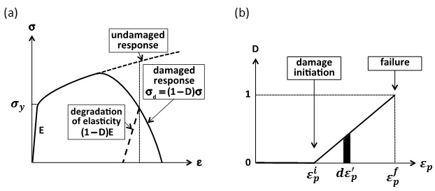

I am using linear degradation; (1-D)*E where D goes from 0 to 1 as strain goes from 0.035 to 0.05.
See the image below, and I want that degradation to follow the linear curve.

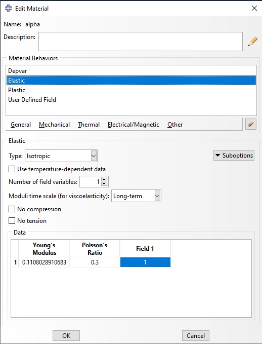

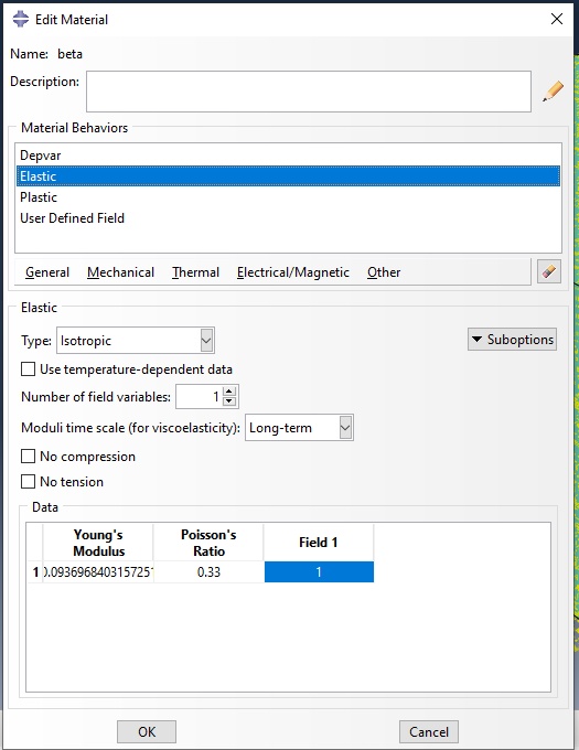

I have defined field(1) in Young's Modulus table (as suggested in the comments), see images below, and my element deletion state variable is 2.
