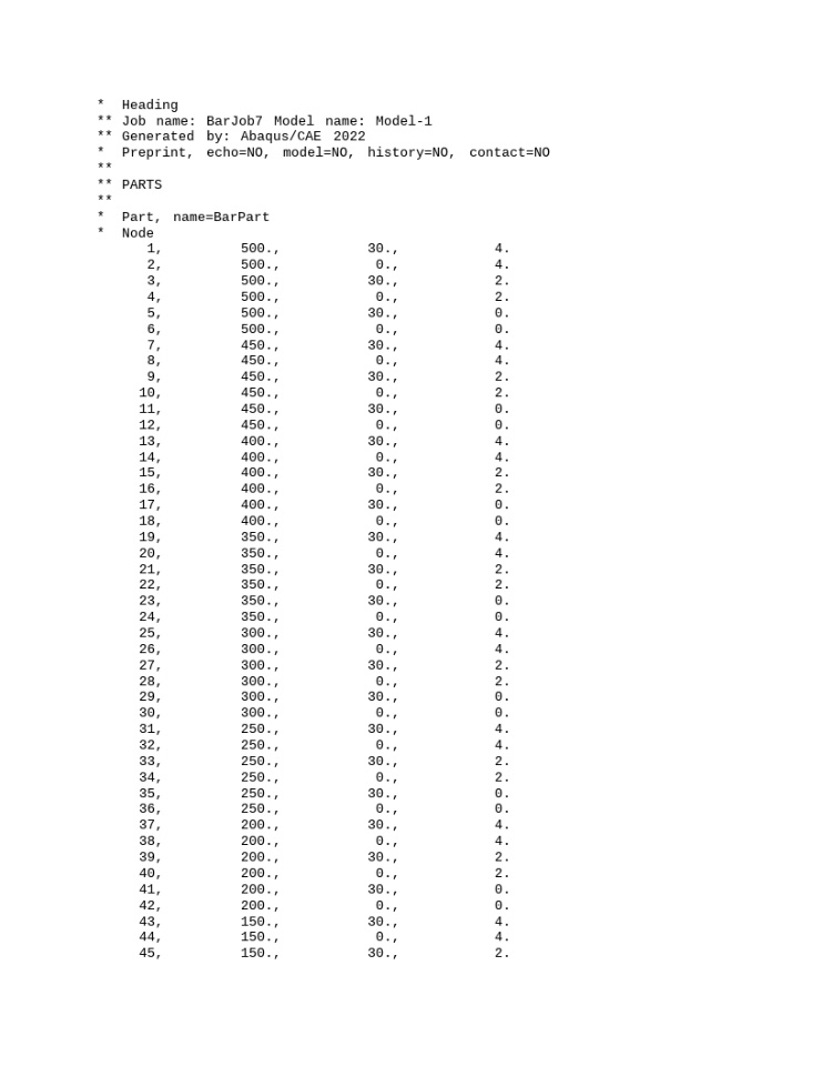

To better illustrate, I set up a simplified example using a coarsely discretized cantilever beam with the following steps:
1. First, I apply a static deflection and request the stiffness matrix.
2. Then, I apply a different deflection and request the stiffness matrix again.
3. Finally, I reapply the initial deflection and request the stiffness matrix once more.
Logically, the stiffness matrices from the first and third steps should be identical, but there are slight discrepancies. These minor differences become problematic when calculating the first and second derivatives of the stiffness matrix numerically.
I've attached the .inp file for this example. Any insights into why this inconsistency occurs and how to resolve it would be greatly appreciated.
