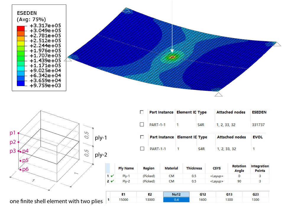

I am working on analyzing a shell structure consisting of composite materials and trying to get the strain energy for each element's ply (composite layer). But it seems not working. The following is an example.
The 60 × 40 shell (plate) is subjected to a concentrated force (F=1e4) at the center and pined at four corners. The size of each finite element is 1 × 1, and its type is S4R. The shell consists of two plies, and the thickness of each ply is 0.5. Thus, the volume of each element is 1. Each pile is set as 3 integration points. Based on the Abaqus analyzed result, I can get the stress (including S11, S22, and S12), the strain (including E11, E22, and E12), and the integration point volume of each play in an element. However, I cannot use these data to match the elemental strain energy getting from the 'ESEDEN.' Taking element 1 as an example.

# Middle surface
When using data at p2 and p5 (the middle surface of each ply):
u2+u5 = 378630.34375 > u_a
# Volume influence
When considering the influence of integration point volumes (e.g., u1 = (1/2)* s_a1*e_al*v_a1):
u1+u2+u3+u4+u5+u6 = 252792.45528262202 < u_a
