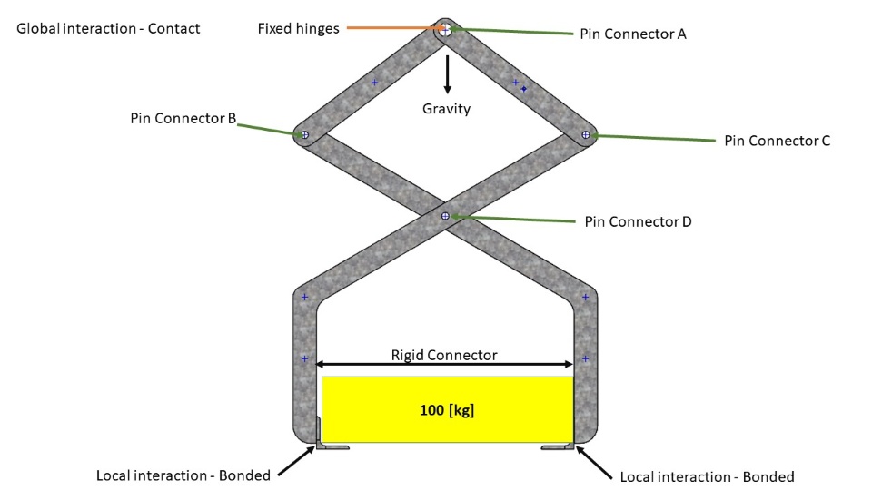

Hi All,
I`m trying to perform a static analysis of the lift device as shown in the picture,
I set a global interaction as contact, and also I set a local interaction between the bars to the angle supports.
I set all the pivots as pins connectors.
About the fix definition I set pivot A ass Fixed Hinges,
When I start the simulation I got an error warning:
"Excessive displacements were calculated in this model. If your system is
properly restrained, consider using the Large Displacement option to
improve the accuracy of the calculations. Otherwise, continue with
current settings and review the causes of these displacements.
Click 'Yes' to solve with the Large displacement flag activated.
Click 'No' to solve with a small displacement.
Click Cancel to end the solution."
I think there is another definition of fixtures that are missing.
Is anybody have an idea?
