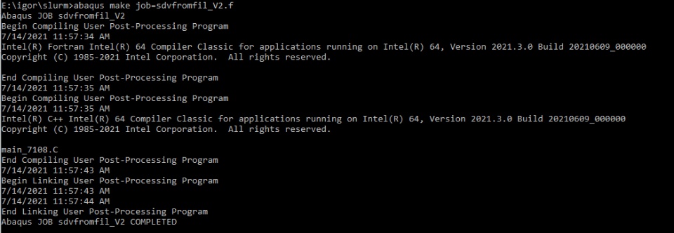

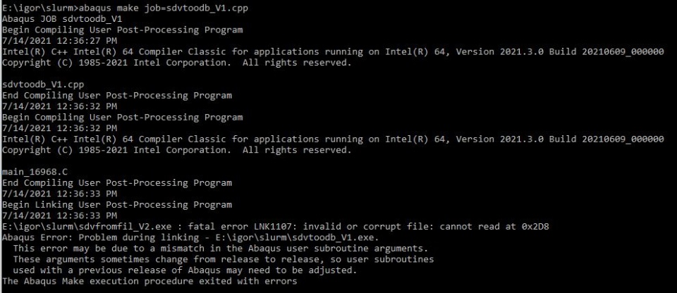

However, when I use abaqus make to compile postprocessing subroutines (fortran and c++) I get some errors. Previously, I used the same codes in linux with Abaqus 2020 and Intel Parallel Studio 2018, and it was working. Now, I need to use Windows and Intel oneAPI because Intel is not renewing license for older Parallel Studio XE. For post-processing, first I compile 'sdvfromfil.f' and then link 'sdvfromfil.exe' with a c++ code 'sdvtoodb.cpp'.  When I compile c++ code, I get following error,
It says sdvfromfil.exe is invalid or corrupt. When I compile sdvfromfil.f before this step something strange happens,
sdvfromfil.f is first compiled with Intel Fortran then again with Intel C++. I suspect this might be the reason for corrupt file. Is this normal? What should I do? Any help is appreciated.
