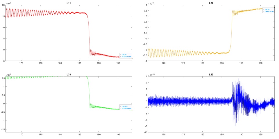

I am using VUMAT to write my own material model and simulate undrained triaxial compression tests in Abaqus/Explicit.
For dense samples, everything is perfect.
For loose samples, which will suffer static liquefaction, the single-element simulation is perfect; however, the multi-element simulation shows weird errors.

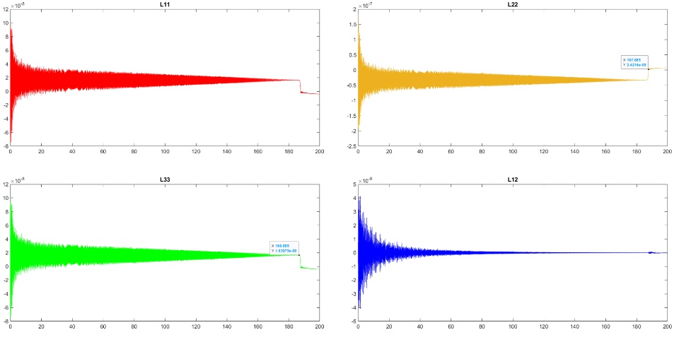

Then I plotted the strain increments of one element in these multi-element simulations, as shown in Fig. 1. Because I am using axisymmetric elements, there are only four strainInc components, At first, the strain increments show significant oscillations, and the simulated results are correct.
However, these oscillations keep decreasing. At about t = 186 s, these oscillations nearly disappear. Then, something weird happens, and the simulated results are getting wrong.
Fig. 2 is the enlarged view of Fig. 1.

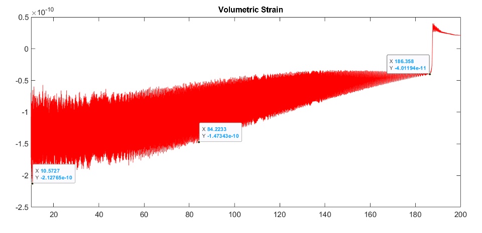

Fig. 3 is the volumetric strain of the same element in Fig.1. Similar characteristics are observed.
