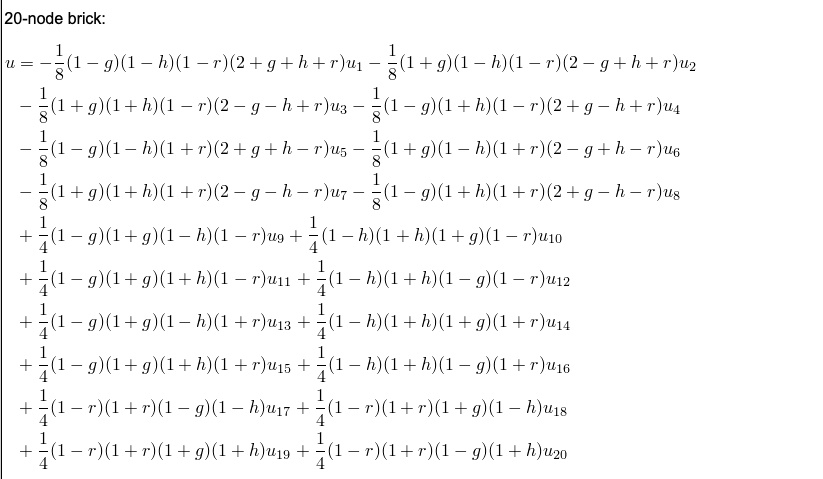

The only way I can think of now is coding the interpolation function according to what is described in the abaqus documentation>> abaqus theory guide>>elements>>continuum elements>>solid isoparametric quadilaterals (see figure attached). I would like to know if there is another way I can go about this.
