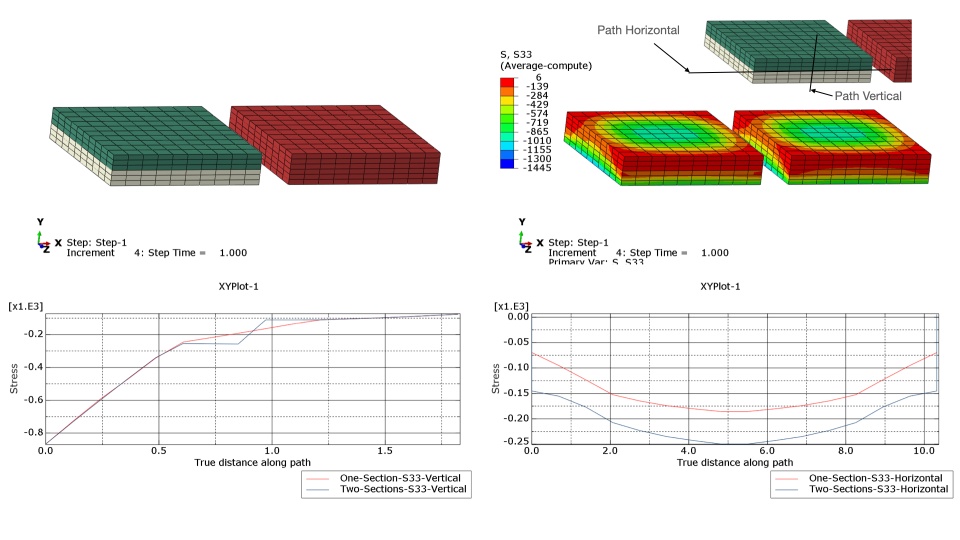

I came to a problem with Abaqus which considering two Sections that share nodes with the same material generate different results with a model that uses one Section. I was wondering how Abaqus want to solve this issue.

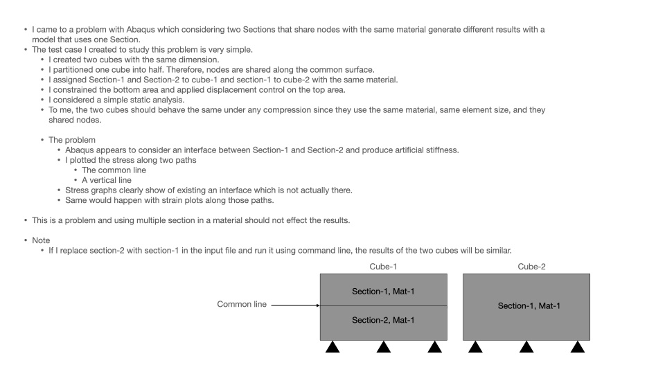

  • The test case I created to study this problem is very simple.
    • I created two cubes with the same dimension.
    • I partitioned one cube into half. Therefore, nodes are shared along the common surface.
    • I assigned Section-1 and Section-2 to cube-1 and section-1 to cube-2 with the same material.
    • I constrained the bottom area and applied displacement control on the top area.
    • I considered a simple static analysis.
    • To me, the two cubes should behave the same under any compression since they use the same material, same element size, and they shared nodes.
  • The problem
    • Abaqus appears to consider an interface between Section-1 and Section-2 and produce artificial stiffness.
    • I plotted the stress along two paths
      • The common line
      • A vertical line
    • Stress graphs clearly show of existing an interface which is not actually there.
    • Same would happen with strain plots along those paths.
  • This is a problem and using multiple section in a material should not effect the results.
