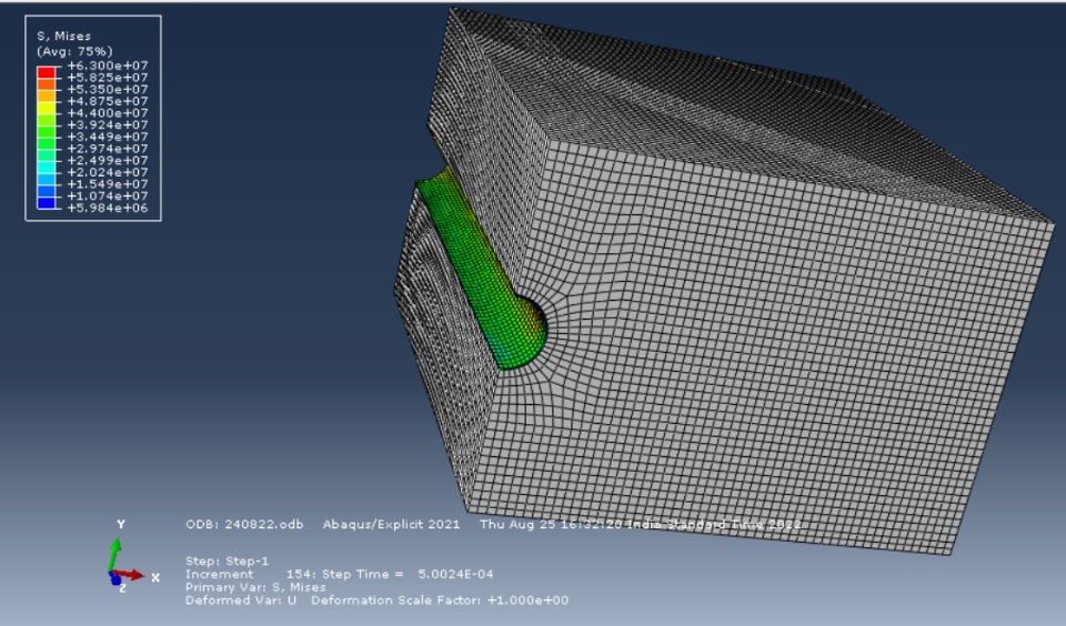

I am working on a model using the Eulerian-Lagrangian meshing technique. But, after running the model, I could not see any stress contour variation in the Eulerian domain, but significant changes in stress contour are visible in the Lagrangian environment. Kindly give me your probable suggestions to resolve this matter.
The attached diagram inserts a pipe(Lagrangian) in the soil(Eulerian).
