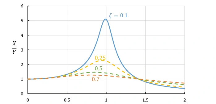

I am new to dynamic analysis and have a question regarding base excitation. I am interested in obtaining a frequency response (or amplification) curve that shows how the dynamic amplification factor—defined as the ratio of the structure displacement to the base displacement (X/Y)—varies with the excitation frequency ratio, r = w_b/ω_n, where w_b is the frequency of the base and ω_n is the natural frequency of the system. My goal is to get a plot like this:
Also, is it possible to obtain both the transient and steady-state responses when using base excitation in Abaqus ? Any help would be much appreciated.
