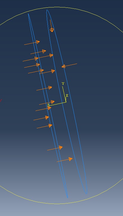

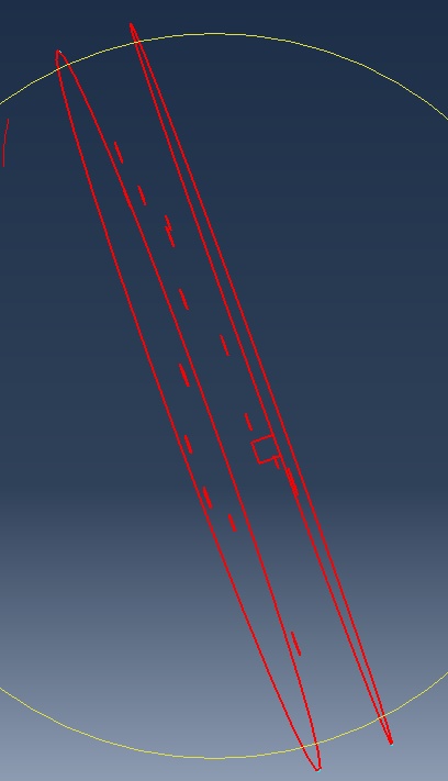

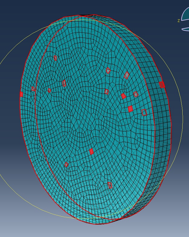

I am trying to find a way (Python code) such that the exterior element surfaces can automatically be detected. However, the following states that this is not possible in Abaqus/CAE (https://classes.engineering.wustl.edu/2009/spring/mase5513/abaqus/docs/v6.6/books/usb/default.htm?startat=pt01ch02s03aus16.html). Is there another way in which I can approach this problem?
My goal is to automatically put (pressure) forces on only the outside element surfaces.

import random
maxelements = len(mdb.models['Model-1'].parts['Part-1'].elements)
x = random.randint(0,20)
for i in range(1,15,1):
   q = random.randint(0,maxelements)
   #Surface is created
   f = p.elements
   side1Elements1 = f[q-1:q]
   p.Surface(side1Elements=side1Elements1, name='Surf-'+str(i))
   #Load is created
   region = a.instances['Part-1-1'].surfaces['Surf-'+str(i)]
   mdb.models['Model-1'].Pressure(name='Load-'+str(i), createStepName='LoadingStep',
    region=region, distributionType=UNIFORM, field='', magnitude=1.0,
    amplitude='Sin')
