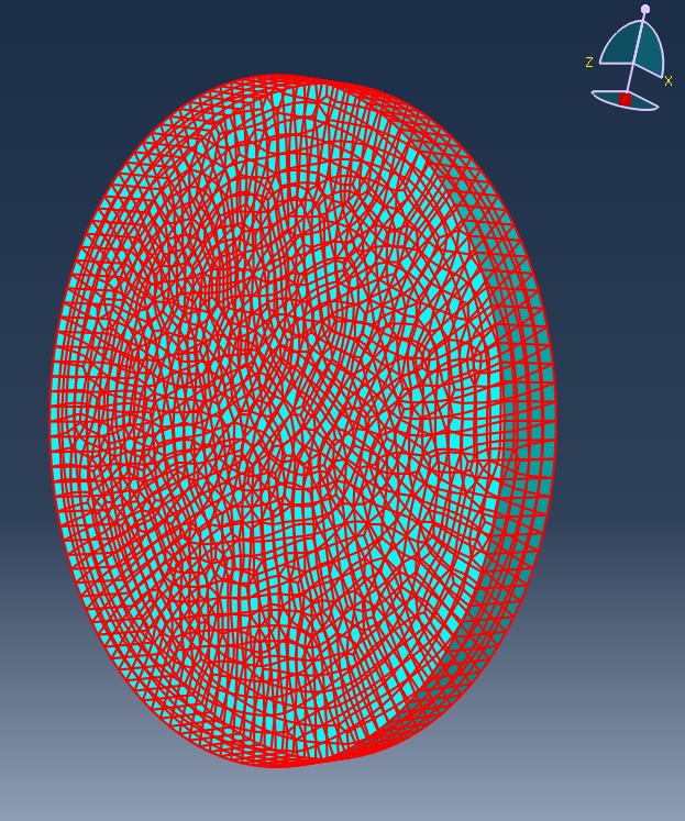

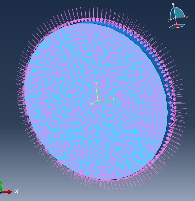

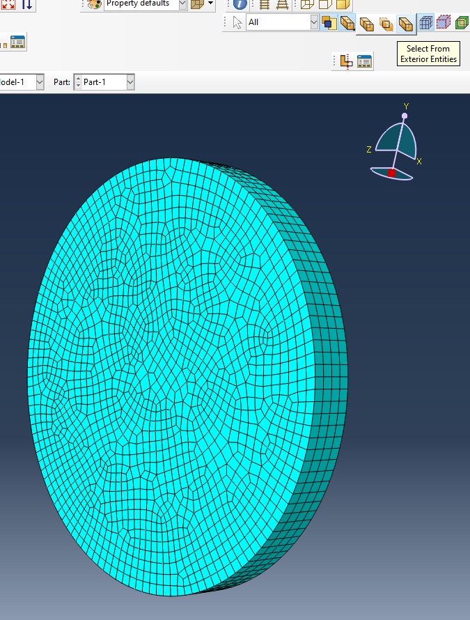

Hi! For the following model, I am creating a script that can create x exterior element surfaces to exert x pressure forces on. Currently, I am able to select all the exterior element surfaces at once, to exert pressure forces on (see screenshots). The rpy. code that comes with that is added at the bottom. I am looking for a way to automate these steps for other Abaqus/CAE files (can be a square, box, cylinder, etc.). Is there an easier way to select an x amount of random exterior element surfaces using Python code?
