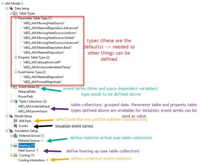

I want to simulate the FDM process using the AM modeler plug-in in Abaqus 2023. I tried to follow this blog, which used either Abaqus 2019 or 2020. However, I soon realised that many options have been altered in the 2023 version. Specifically, after creating the AM model, I can only define Event series, Materials input, Moving heat source, and Cooling, as shown below.
There are still considerably many options missing, compared to the aforementioned blog (shown below).
I'm wondering what the workflow is. This is what I've done so far:
