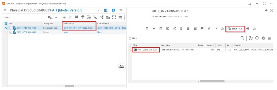

The "Make From" option in Engineering Release (XEN) does allow to link an origin object to define manufacturing history. This works perfect as long as I'm inside the XEN widget > can be displayed as column inside the list and even material propagation works fine.

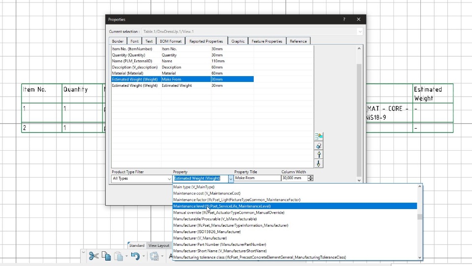

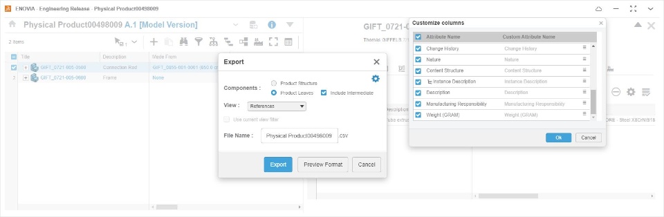

When trying to export this information now via e.g., CSV out of XEN, this column does not appear as exportable attribute and also when using BOM inside CATIA, this attribute does not seem to be supported (like core material what also is just a linked information).
Is this function just missing (or did I miss something?) or is it not intended to be exported > and if > what is the reason, if only can be seen inside the Engineering Release app and not be reused?
