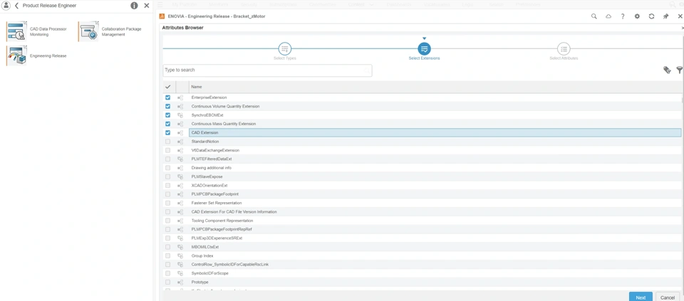

At Step 7 I cant't find drawing or drawing of in attribute
Step 1: Open Relation Control Center App(in picture)
Step 2. Relations Set: Engineering Definition Relations
Step 3: Add Solidworks relations Drawing & Drawing of
Step 4: Add Applications Engineering Release
Step 5: Deployment Server -> Update Index Model
Step 6: Open Engineering Release
Step 7: Add Attribute(Extension Sets what I used is in picture)
