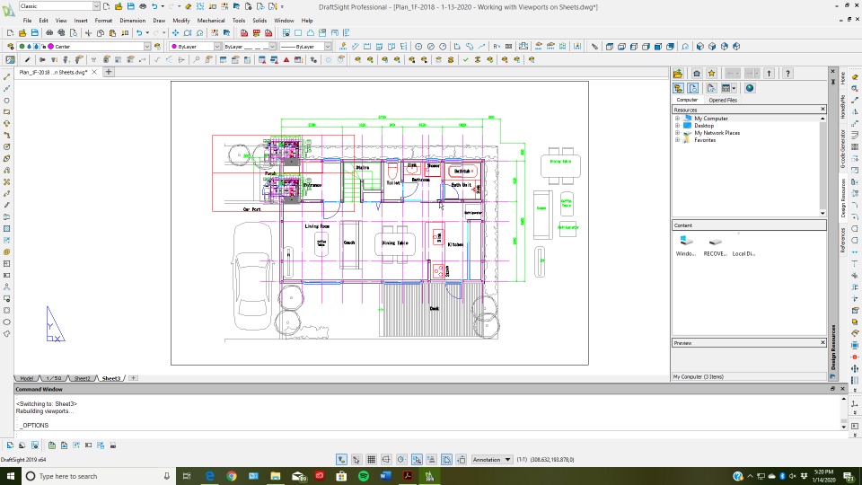

Viewport on existing sheets separate from rest of the drawing?
I received a response to my question last week on printing Viewports. However, it does not work. See Below.
"I'm following the instructions on "Working with Viewports on Sheets" in Help The upper left corner is where I'm trying to create a Viewport with. in DraftSight 2019, but where it says " When printable area is turned off, the view port fits the entire sheet." I Do Not Know How To Turn Off Printable Area."
Response: Paul Myers - Hi to turn off the printable area do the following: open up the options dialog box (type options into command line), then click on system options, next expand the printing options and then expand the general options. Then uncheck the display printable area option. Now click apply and then ok. Hope that helps. Paul (A Draftsihjt 2019 Standard SP3 User)
Answer: Patricia Shenk - Hi Paul! Thank you for your message! I tried it but the entire original drawing is still there! Attached a screen shot. Any new ideas? Thanks!
