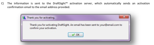

Once the program is installed, it repeatedly asks you to enter in your email address etc. However the reassuring "thank you for activating" message never pops up, and then no corresponding activation email is ever received.
Does anyone have any ideas in what could prevent the installation from accepting the form info filled out and saying an email was sent??
