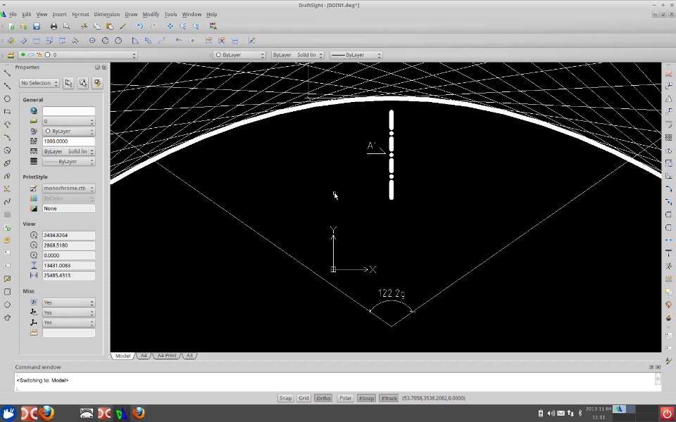

Hello,

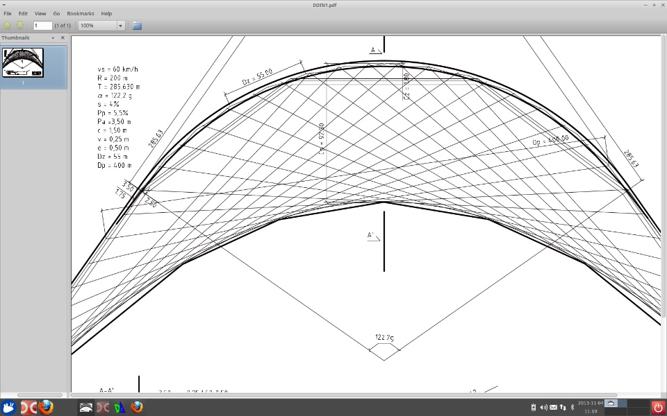

I have a problem when exporting drawings in PDF format. As you can see in the first picture, I created an arc (the thick line) using spline function and an angular dimension. And in the second picture, you can see how it was exported to PDF, the dimension is just three lines and the spline arc too are just lines, but you can also see, that the arc on the very top, the thick one, is drawn quite nicely, it is a regular arc, created using just an arc function. Another thing is, that line styles do not export properly, you can see that too. Also when I try to send the drawing directly to a printer, it prints just fine, even with line styles. But I need to print this one on A3 format, so I really need to export it to PDF and take it to a printer at work. I tried changing almost everything in print configuration and nothing helped. Does anyone have any idea how to export it properly? Thanks
Petr
EDIT: I managed to do a workaround. I changed style of that spline arc to dashed and changed scale of it to some ridiculously high number so it will look like continuous line and it is exported perfectly. This problem occurs only with continuous line with line scale set to any number. Reason that that top arc in the second picture is as it should be, is that it is dashed in the drawing too (but looks like continuous for some scaling issues). Problem with that angular dimension remains though.
