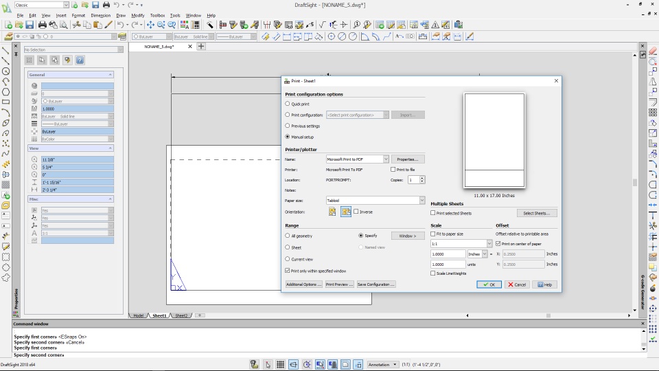

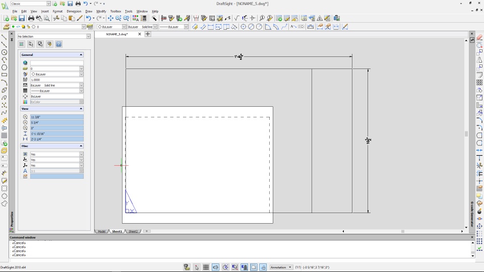

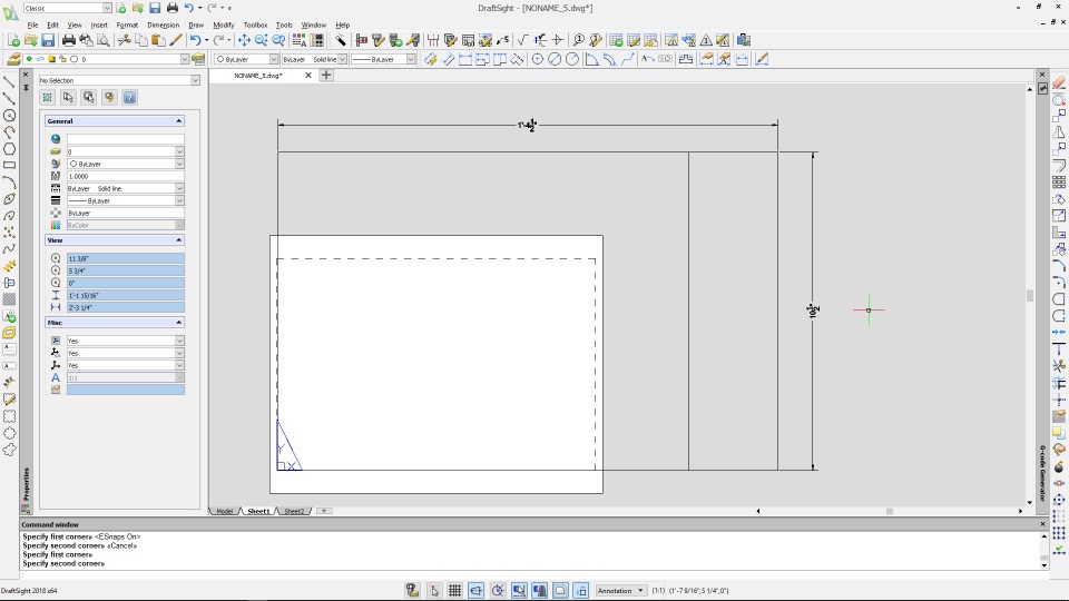

Hello Forum. I'm new to CAD, which makes me new to DraftSight. I'm having an issue with setting up Layout pages. I'll only be using two sizes: 8.5"x11" and 17"x11". If I open a titleblock, copy it, delete it from paper space, then I'm able to paste it to the layout sheet, which is never the size I need. So I'm able to monkey around with the page setup enough so that I get a Tabloid 17"x11" layout sheet. But that produces a layout sheet devoid of the dashed boundary lines, leaving me guessing where to actually place the titleblock. That's like drawing a line and guessing whether it's 8ft long or 10ft. Although this is the 2018 Professional version, I can't find documentation on this. Anywhere. Or maybe it's there and I just don't know how to find it. All I know is this is a critical piece in a finished product, giving the client the ability to have a PDF for review. So if there's anyone here who can help me on this, I'd surely appreciate you.
Here are a few pics showing what I see. The first and last look the same. But the last pic is taken after changing settings shown in the second pic.
