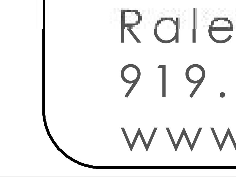

Lines and text turn into rasters on top of images
Hi, I looked in the forum for anyone else with the same issue but didn't find anything similar so hopefully this isn't a repeat question. I have reference images (jpeg, tiff, etc) in my Model space and layouts. When I draw over top of the boundaries of the image (text, lines, etc) lines get 'rasterized' when printed. See attached image. The image is above the text (out of frame) but there's some white space at the bottom of the image that overlaps with the text. You can see the edge of the image bisect the letters "Rale" and see where text border changes as well. I've made sure the image was at the bottom of the stack and looked through all the preferences but haven't found a solution. Am I missing something or is this a deficiency in DS? Running Windows 10 (had same problem in 7) and DS 2016 x64 SP1. Thanks in advance for any help!
