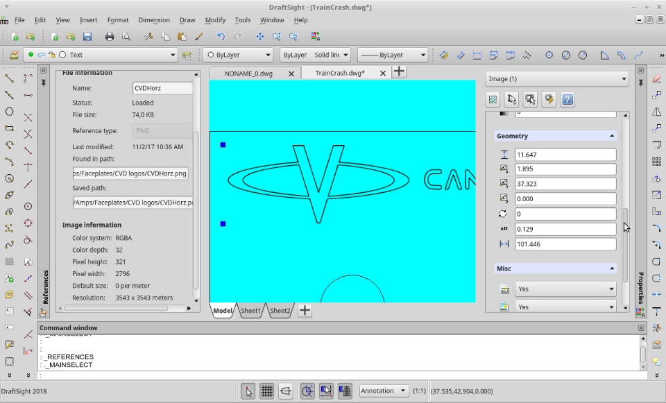

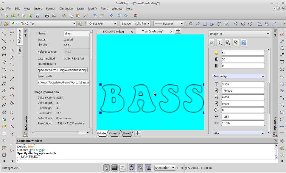

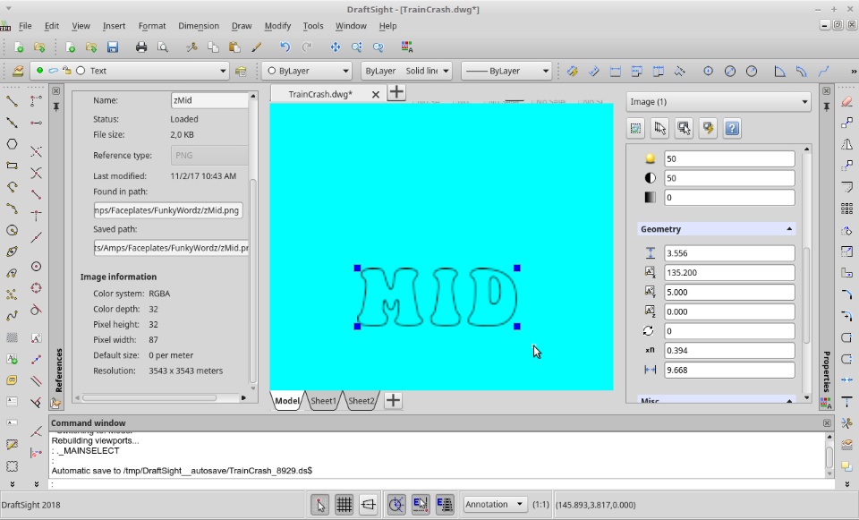

The first image I inserted, my CVD logo, looks ok but the others are becoming pixelated. I've tried saving in different sizes and using different scale values when inserting them but still can't get good quality. I attached an example of the word "BASS" in the original size and 32 high size as well as some screenshots of Draftsight. I also attached a shot of the word "MID" which was inserted in the original larger size but shows up as 32 high in the Reference Manager.
I started with an .svg image about 380 x 100 pixels and saved to a .png. I had to scale up to a value of 10 to get the right size proportional to my drawing after inserting. It was too pixelated so I tried  saving as a much larger size and setting the scale to 1.  It was still pixelated. I noticed in the References Manager that the image height after inserting and resizing was 32 pixels so I saved the image to .png at 32 pixels high and inserted with a scale value of 1. Still pixelated.
I have the IMAGEQUALITY set to HIGH. The image size in the Reference Manager is 32 high no matter what size I start with. My CVD logo has a much larger resolution size in the Reference Manager that is not relative to the displayed size in the drawing.
